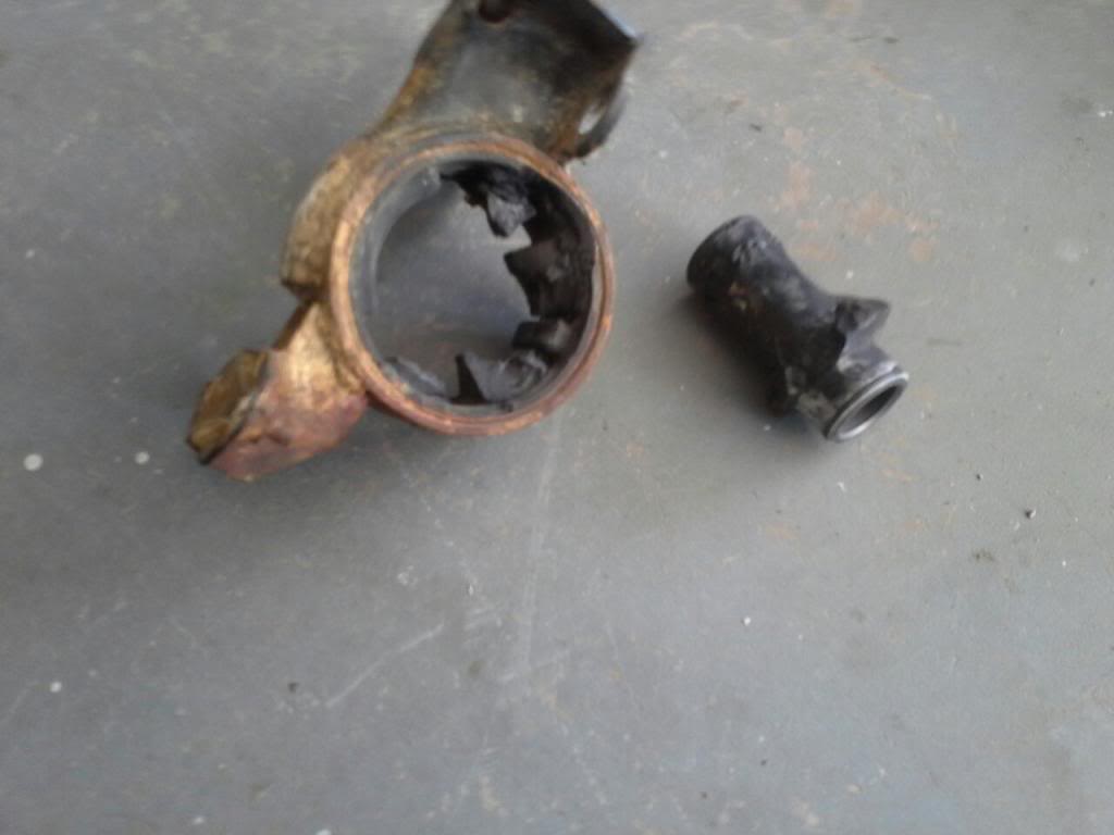

This Is The Old Motor Mount!

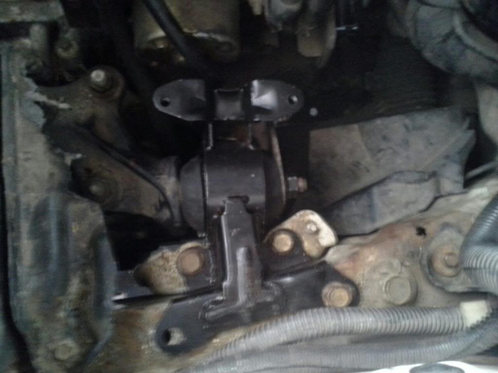

This is the new one!!!

But it still shifts hard from 1st to 2nd any ideas anybody?

Sticky valve maybe?
I wonder if it is shifting hard when you play feather foot. Try accelerating real slow.
