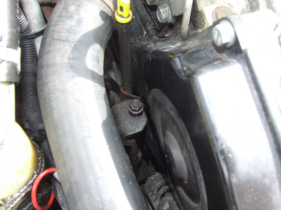

I've got a squeel from my belts when I start my car. Checking the belts, they look decent but might be slightly loose. I've looked up belt tensioner and have seen pictures but I don't see anything like that on my car (Mazda MX-3 GS).
I took a picture, please take a look and let me know if this is it.

I know you have a Chilton manual. I am sure it covers the drive belt or serpentine belt tension. Serpentine belts usually have a spring loaded tensioner. The Protege however has 2 serpentine drive belts and their tension is set by moving the power steering pump and the alternator respectively. Bad bearings and pulleys that are too smooth can also cause squeals. You can roughen up the grooves of a pulley with emery cloth.

Thanks Tan, I did look in the Chilton Manual and the shop manual I have. The did show the tensioner, but when I got under the car I didn't see it. The only thing I found that could be it is the part I took the picture of. That is just a metal piece that is attached to a pully. It's not attached to anything else, it has a long bolt that runs through it. The bolt goes from the top of the piece to a piece attached to the pully.

I don't have a car to compare your description with. I wonder what the manual says about replacing the belt. When you do that you have to release the tension somehow. If it says "use a breaker bar to push or pull against a spring then you have a belt tensioner. If it says " loosen bolts at the alternator or another accessory" then you don't have a tensioner. In that case the thing in your picture is an idler pulley.

another thing to consider is, judging from the picture, that area is dirty with excess oil. if you get oil on the belts, besides making them slip on the pulleys, oil will make the belt expand. if the belt(s) are oil contaminated, tightening up the slack might make them break, leaving you stranded. you should first solve the excess oil problem, otherwise, taking up the slack or installing a new belt will only be temporary. if there is a timing belt under that cover, i would bet that sucker is really soaked.

From the diagram the bolt I was referring to is the adjusting belt, that helps a lot Tan.

The "why" was because the belt was loose, I tightened it (it is the same as my picture and the diagram Tan provided) and it works great, no more squealing. I'm not sure how to see if it's too tight now (well I know how with the gage but I don't own one), so I figure I'll loosen it a little until the squeal starts again.
