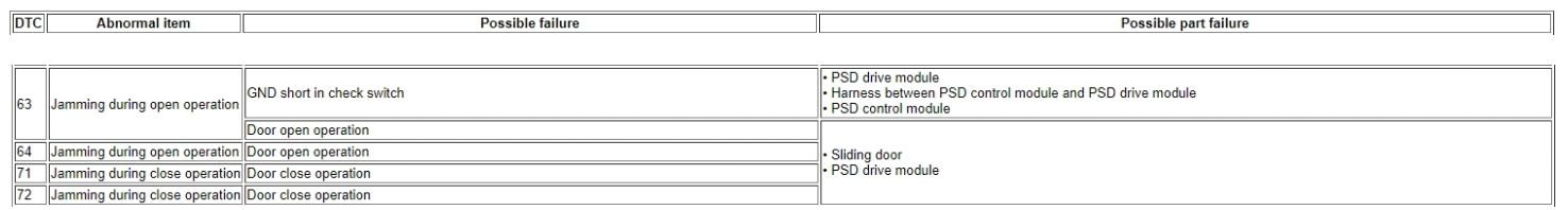

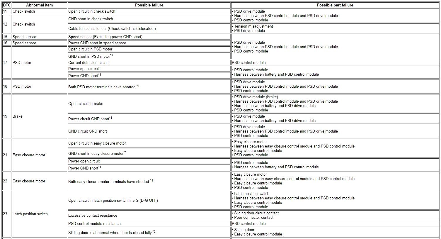

I'm having the same kinda issue passenger door works fine drivers side door will close with the electric but will not open with it I have to open manually if I try and open it all it does is beepI did the above procedure and got 12,15 and 23

Hi,
Here are your code explanations (see photo).
Regards,
Scotty
Old Mar 12, 2022 | 10:44 AM
Scotty Bailey's Avatar
Joined: Aug 2019
From: Wellington
Hi,
Explanation for code 71 (see photo):
Regards,
Scotty
