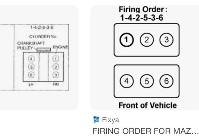

Hi everyone
I just picked up my mazda from a mechanic, who has provoked misfires on cylinder 2 an 6. He is convinced that bank one has cylinder 1, 3 and 5, and I am convinced that bank 1 has cylinder 1, 2 and 3. So he refuses he did anything wrond and wont fix the problem and i think hes checking the wrong cylinders. Does anyone have an official source for the cylinder placement on this car so I can finally settle the dispute?
Thank you everyone!

That answer is all over the internet and simple .

Thanks for the reply. I know its easy to find but the mechanic refuses to believe it unless I have a proper source. Anyway, it's not that relevant anymore as I found upon visual inspection that they connected the cylinder 4 wire to cylinder 6 and vice versa (cylinder 2 and 6 if you use the Ford nomenclature).
After 5 hours of diagnostics they still didn't manage to see a super obvious error. Sometimes mechanics can really surprise you
