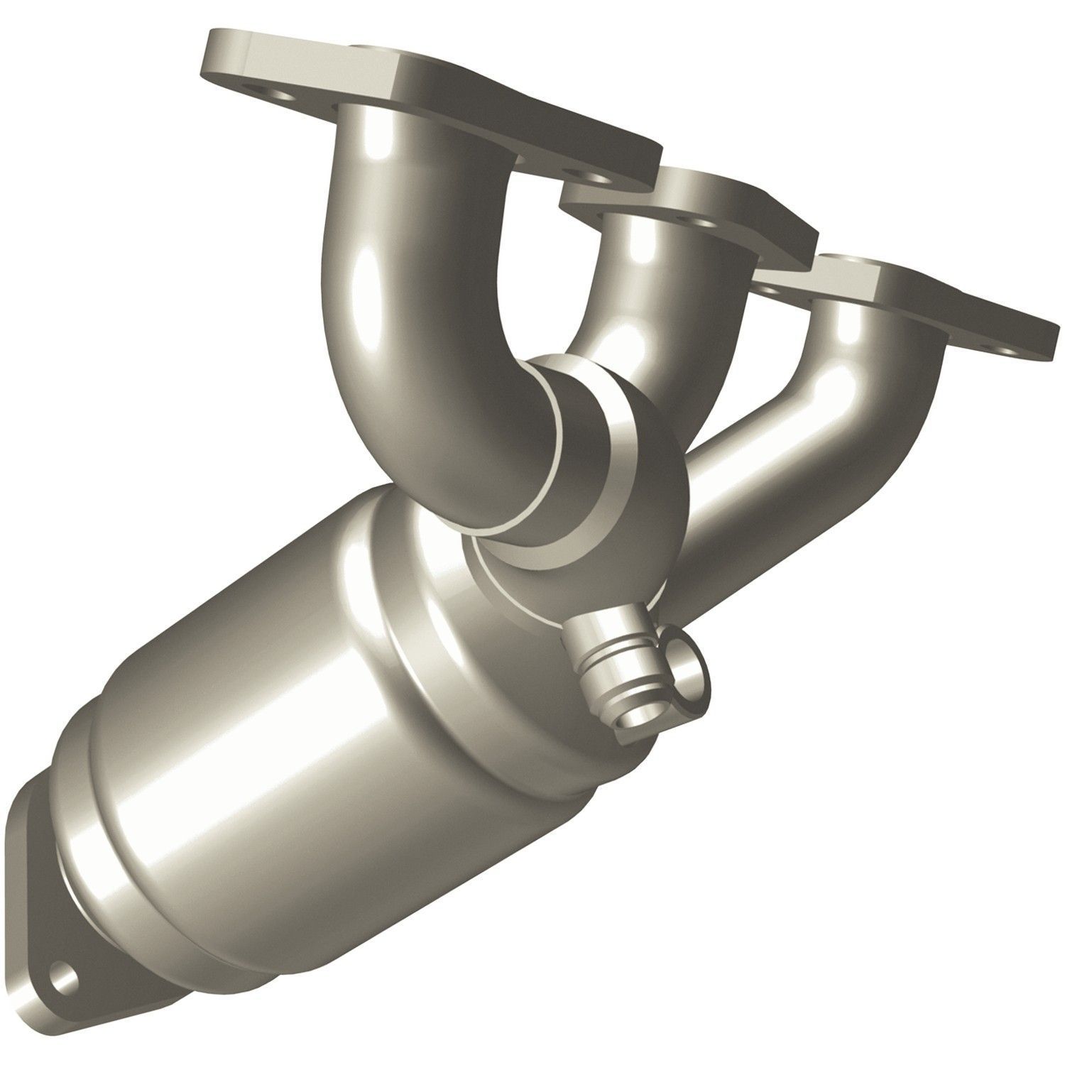

The muffler shop I spoke with said they couldn't weld a cat given the unusual size. Does that sound right? Attached is a picture of the bank 1 (front right) cat.

Then if your information from the California Emission Testing site is giving you the correct informatio9n to locate an approved CAT and there is none available then you can file and get an exception.
Other wise you will need to travel outside of CA if you want a replacement part that is not CA emission qualified. I can teel you if you do that it will pass the visual as well as the tailpipe test if it is done and also if installed correctly should meet the input sensor information from the H02 so as not to cause a DTC.
The other problem in CA you can't even sell your MAZDA or any other vehicle that has this problem and you are not likely to be able to transfer a sale to someone in another state with a CA open emission requirement?
Ok that about all my advice on this thread, good luck
