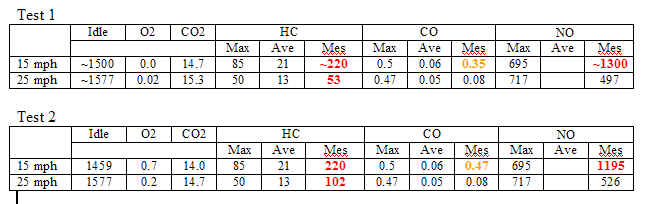

After fixing my 2.5 L, I have trouble passing CA emissions. I have gotten it tested twice and both times problems in same area with similar numbers. They are as follows:
I have failing HC and NOx. Hax high CO at 15 mph but passing. I don't have test 1 in front of me but is similar to test 2. See the attached thumbnail for test data.

Attached Thumbnails Millenia SMOG failed High HC and High NOx-millenia-smog-2.jpg

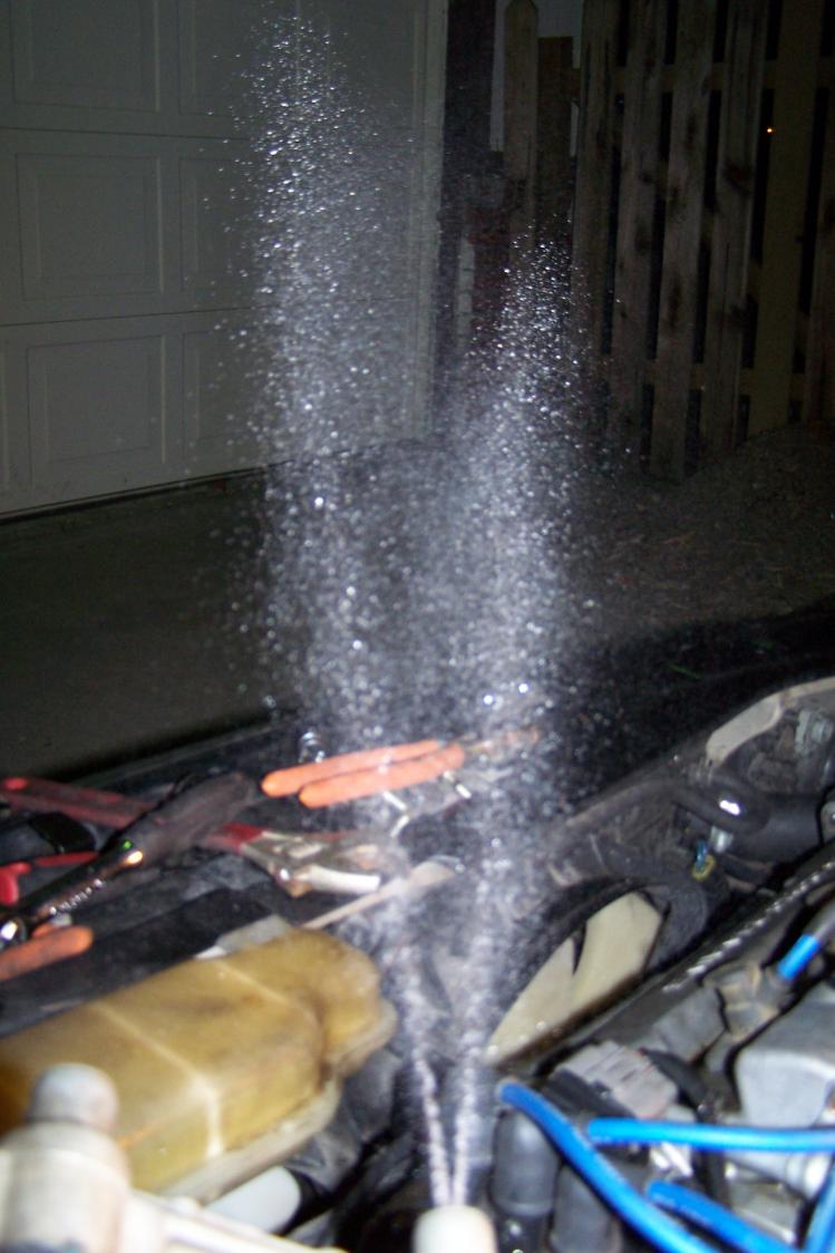

Thumbs down Injector Spray Pattern
This is what it looks like (see thumbnail). All six are the same. Looks awful to me, what do you guys think? They do not drip after close anymore like I said in the previous post. The cleaners must have cleared that up.
