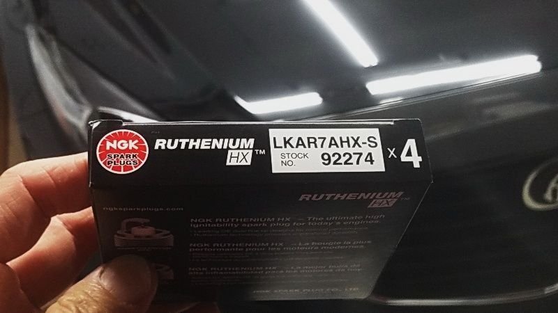

Exclamation NGK Spark ruthenium hx
2018 Cx-5 Grand Touring, NGK OEM plug is ILKAR7L11. This is the plug to use. The RUTHENIUM plug LKAR7AHX-S is " a step Down and is only a second choice".
This came from NGK (Niterra) tech support. (
877) 473-6767
Also..... Don't use anti-seize. The plugs are made with a special finish.
