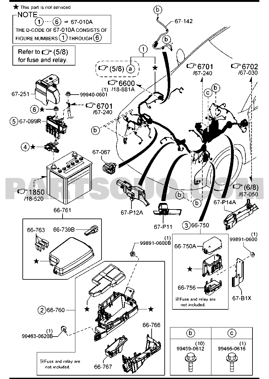

think I may have found out where they stuffed that relay... looks like it's in a separate relay box somewhere near the engine compartment relay/fuse box according to these pics. Will post back tomorrow with what I find.. cooling fan relay box is labeled 66-750 on this diagram
Old Oct 5, 2023 | 09:48 AM
Posts: 10,664
yes that is where it is at. the relay location is illustrated under the cover.

So, I've located the cooling fan relay, which is located right behind the driver side headlight, but everything seems to check out just fine. Tested the relay with a spare 12v battery and multimeter, and it gets continuity with around 100ohms, which I'm not sure if that's normal or not as I can't find any specs online. The relay itself is a 4 prong labeled PY8W 15 651 / V23134-J159-X536 / 12V / +=1645
I thought the diagram I posted above says there should be a fuse in the box as well, but can't see any fuses.
