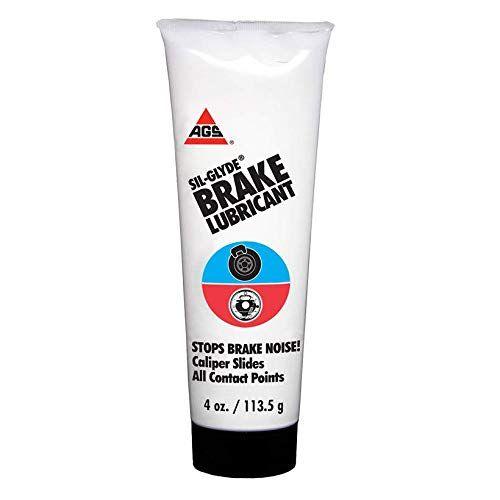

Old Mar 13, 2020 | 02:37 PM
Bronco Boy's Avatar
Joined: Mar 2020
Posts: 50
From: Coquitlam
This has never let me down.....
