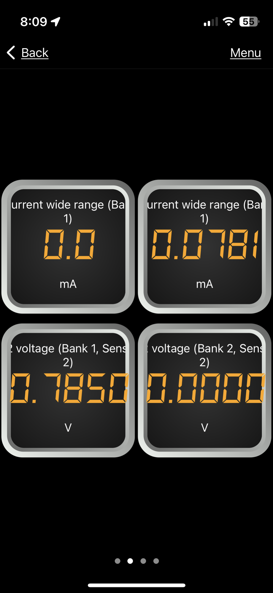

This is what I get with my scanner.

This phone aps often don't work very well. Please get or have done and connect directly to the OBDII diagnostic connecter with a quality Diagnostic scanner.
Sorry but those reading look more like a transfer of information blue tooth issue then actual information form the ECU
I need a mic to post write for me because of length of explanation information on all the problems with that reported screen shot and possible problems and inaccurate reporting information.
Sorry.
You could have a failing CAT, failing ECU, failing fuel pump, failing IAT,MAP or other sensors....etc etc etc..

I did borrow a friends plug in hand held unit and got 5he same readings.
with 2 sensors not reading it leads me to wiring.
car runs great despite the code, weird
