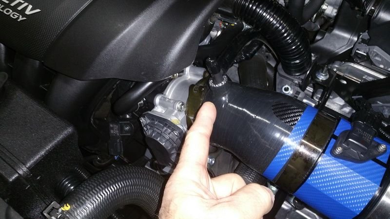

Charged $100 for a carbon/contaminant clean.
Would love everyone's opinion on the picture, is there or isn't there carbon/contaminant build up on the throttle body?

Carbon is baked oil. Oil won't get to the throttle body butterfly (what's in the photo). And, the butterfly won't get hot enough to bake oil. The throttle body parts do build up some crud. No air filter is 100% effective. If one can remove the intake tubing enough to get to the butterfly, spray some throttle body cleaner on a lint-free cloth, wipe it with your cloth covered finger, you now have a clean throttle body and $100 in your pocket.

Thank you for the information. Seems the person servicing me may have exaggerated the severity of the issue. I hope I'm not wrong in thinking that.

That looks pretty bad & in need of a good clean.

what year is the car and how many miles on it?
Did you need it or mechanic recommended it? Did it make any noticeable difference at all possibly not taking into account the placebo effect?

I have to totally agree that this is one of the worse case overdue Throttle body need service work . The pictures do not show other vital area's but you might just look into a rebuilt Throttle body instead of having this one service only to find that the shift is worn
The year or miles has nothing to do with the question about this throttle body needing either replacement or a complete service. Service is defined in the case of the pictures likely more then just a cleaning!
Oil from blow by in the crankcase in some model engine inductive system can introduce oil into the throttle body and a throttle body can get to a temperature that it can cook that vaporized oil.
Although most catch -cans do not work as some claim I do run one on the breather side and mount it as low as possible to improve its efficiency. In the picture you can also see that the factory breather tube does run in front of the throttle body and that oil vapor and deposits can under condition that vary get into the Throttle body.
