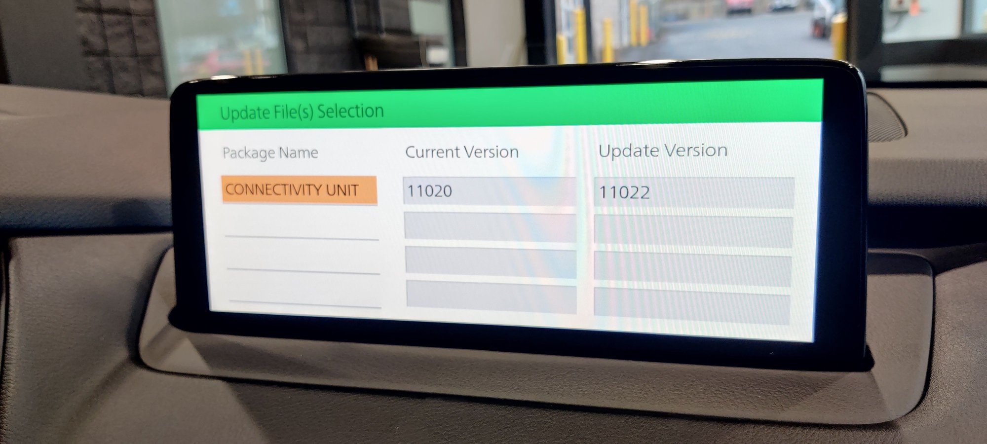

I had to take it to a dealer for the update. Although Android Auto has a built-in update feature, that doesn't solve the problem. The dealer however has the necessary software / tools to perform the update.
Just check the version you have installed and if it's anything less than 11022, you're eligible for that update.
Attached is a photo of the software the dealer uses to identify what you have compared to the latest available.
