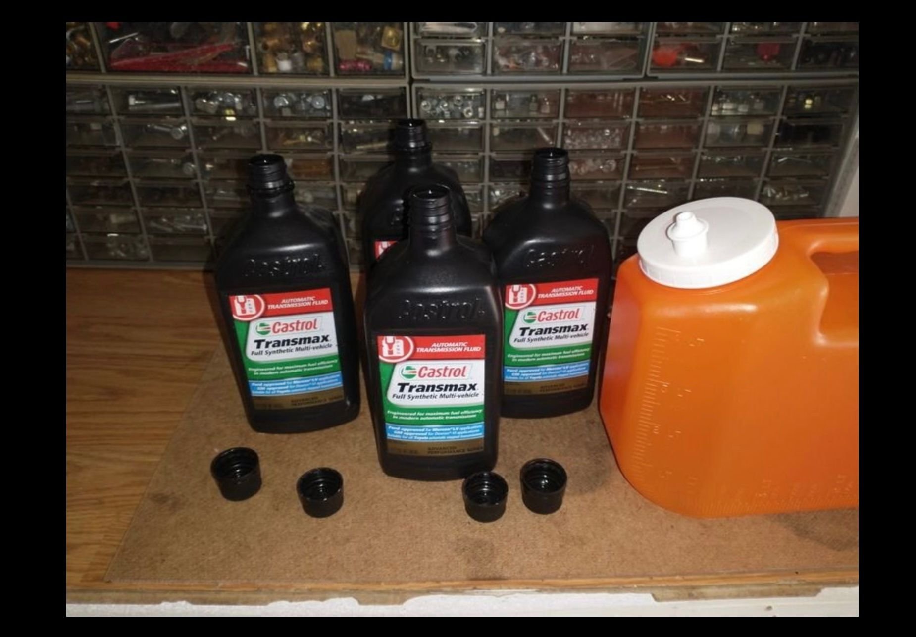

Gotcha. Thank you. When you said Castrol, can you tell me which one you are referring to? I see There is the universal ATF/CVT one that has FZ compatibility on the back of bottle but the Import Multi Vehicle one does not list FZ as compatible.
Also I have like 4 gallons of Valvoline Multi Vehicle ATF here. Looks like that is compatible as well. I stock these because both of my kids' Lexuses use Toyota WS and they have been running excellent with this Valvoline. So could I just use that?

Can't find this stuff at a good price so I'll get the Aisin FZ from Rock Auto. Thanks my man.

Well I can only advise what I personally use what we predominantly use for clusters transmission and and know works very well fact supported by oil analysis.
Will other ATF work sure , will it works as good difficult for any to say because of options and one real testing and even less empirical facts from oil analysis.
I also know through experience that adding it or only doing a pan filter service will never cause issues .
Aisin is a well known for developing automatic transmission and as such they have their own formulas for ATF . I have used it and occasionally we use it in the shop. But I can say with facts or any usage that it is any better the other brands ? So choosing it you are unlikely to have any problems from its use.
