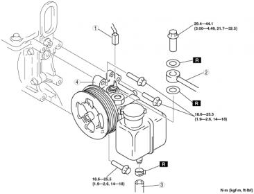

Looked online, not much info. I barely got the serpentine belt off. What a pain. I can see two bolts on top of the pump, but I can't see what's holding the bottom on. Trying to get to the thermostat to replace it. Thanx.
Old Mar 14, 2015 | 12:43 AM
Posts: 7,847
2.3 turbo or 2.5 non turbo or 2.2 Diesel?
2.3 turbo has two bolts on top & 1 bolt underneath

2.3 turbo. Thanx, Ill feel around fro the bottom bolt.
