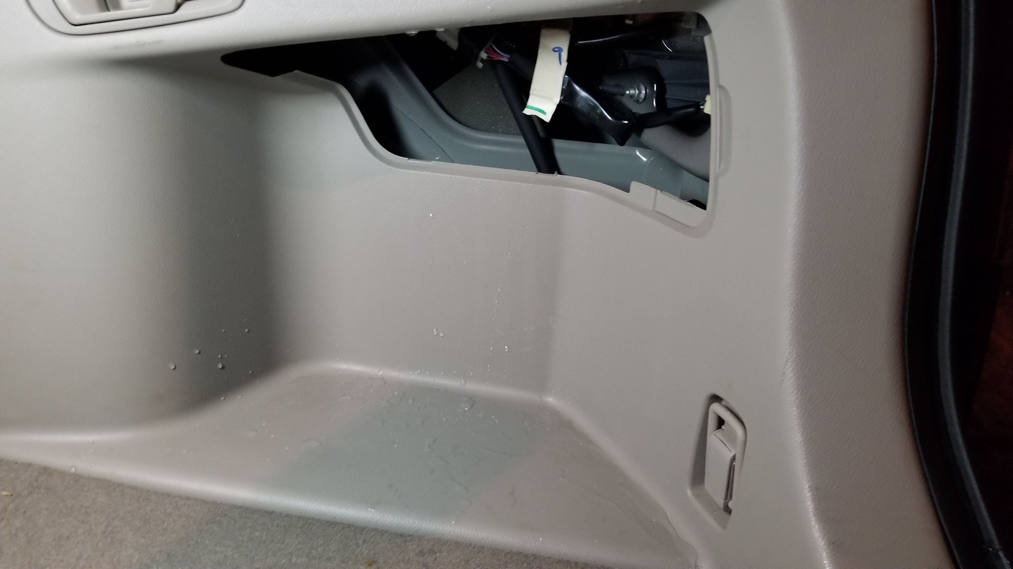

Unfortunately because of where the leak is located it's very difficult to tell where its coming from even if I had a helper. My only options are hoping someone on here had the same type of leak and was able to source it out to save me the trouble of ripping the back trunk apart. Or I invest in a scope camera to run it up inside. this picture below is all I can see looking up where the access panel would be. the water collects on that bit of insulation and drips through the access cover pools in the corner and runs down into the spare tire well

Ok well yes actually you can if you apply the water from the bottom area and working your way to the top very low volume. It how we do it in a body shop. You can also get also fill a bottle with a high-volume spray nozzle with 50/50 isopropyl alcohol. This way if you don't see where it is coming from you may smell it and narrow down the area of the leak.
On Coupes and Sedans, The taillight. That would be my guess.... There is a gasket between the taillight and body and if it is damaged, aged or was never properly seated can cause leaks in the the trunk and rear quarte section area.

I ended up removing the rear plastic pillar to have a better look. Wow Mazda uses little to no insulation in their cars! I always wondered why the cabin interior got cold really fast after just a few minutes with the heat off. My old 07 Hyundai tucson a cheap basic car was designed better than this thing... Anyways I poured some water on the roof and around the side window it appears to be coming from the roof and not the window so there's a start... However this is where it gets very confusing because it's leaking from the roof somewhere, it's not leaving any telltale signs on the headliner that in my opinion would be better because it would be easier to pin point. This leak is trickling in an area where I can't easily see it regardless if I used isopropyl alcohol to sniff it out. There are metal panels overlapping eachother making it super difficult to see where its coming from I'm going to have to rip more of the back interior apart to figure this out. It's possible this leak is coming from either the roof rail or rear boot door strut support thats bolted to the car
We're supposed to get nothing but rain monday and Tuesday so here's my plan. I Have these cheap brown napkins from McDonald's that I am going to place in the suspected areas and if one of them is wet or more saturated than the other I know thats the general area where the leak is coming from.
Also is that pink thing an air bag!? If it is Would have been nice if mazda had put a warning on that panel!
