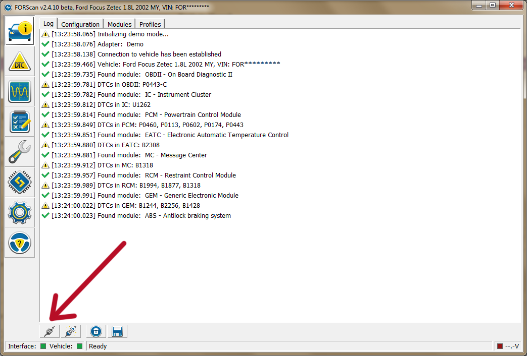

It's simple, you have to add PIDs to dashboard from list of available PIDs.
1) Connect to the vehicle (on the fist screen using connect button below)
2) Select Dashboard, click on settings (gear icon), select module (PCM or ALL), filter by "PM_", add PIDs to "selected PIDs" column, save your setting, press play button

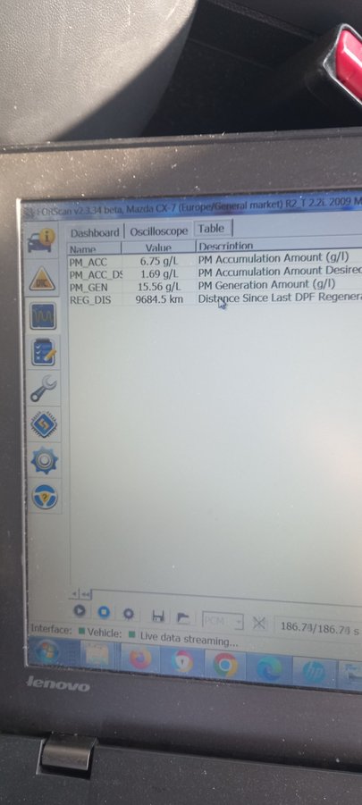

Thx again 4 your your help. This is what i can find, but i still cant see where i can find the % blocking. Previous owner had no idea about cars and has been using it witout dpf regenerating for 9600 kms !
