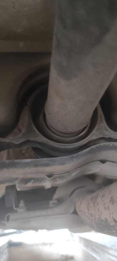

moreover there is something about the driveshaft not sure about it , the driveshaft doesn't look in middle of the mount as the photo , it doesn't move but not in middle there is more space on the top more than bottom
