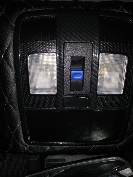

Old Sep 22, 2022 | 04:50 PM
Posts: 10,587
Originally Posted by JerryV
My sunglasses sometimes vibrate when stored in that handy overhead compartment. This drove me nuts until we figured out where it was coming from. Sounds from inside the car can be very difficult to pinpoint.
The felt material I installed in my overhead. No sunglasses rattle... lol
