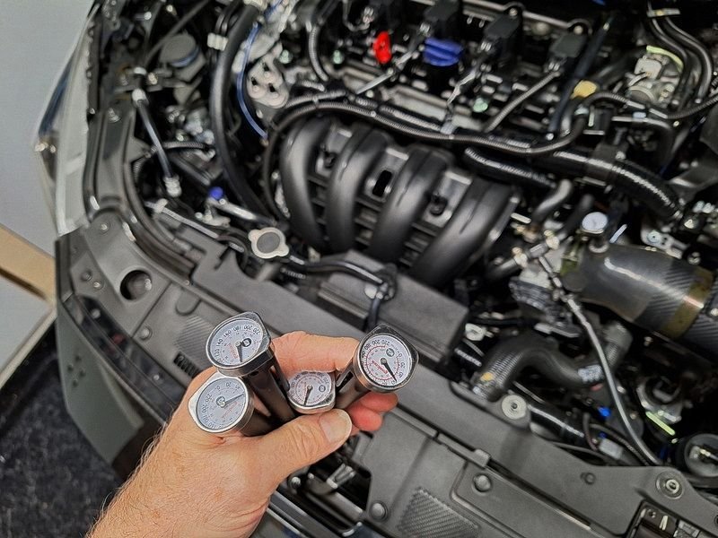

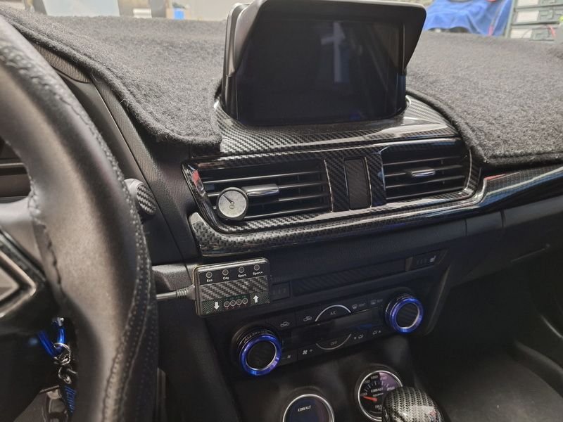

If someone wants to know the actual temperature of the air coming out of the HVAC system and top vent that has the highest flow just but a very inexpensive kitchen temperature gauge used for cooking.
These can easily be placed in many areas for a quick fast and accurate temperature reading.
I use them so often I have plenty on hand for myself and a few friends or good customers.
