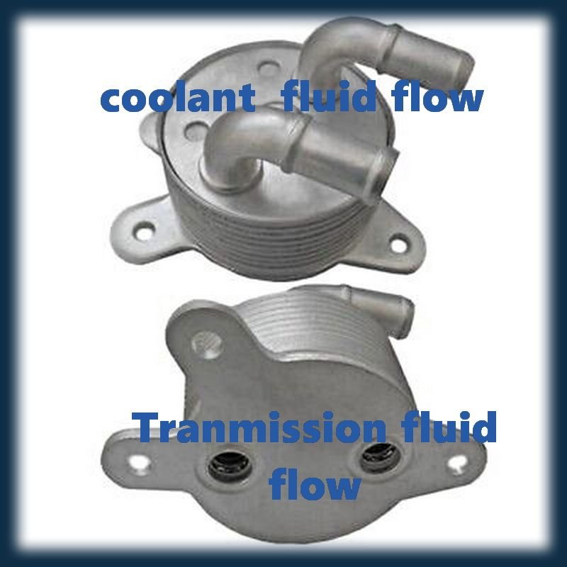

General service answer: Mazda coolers have both the engine coolant and transmission fluid running through it. It is actually a heat exchanger not really what we would call a "cooler". Depending of the transmission health prior to the "cooler" failing or the o-rings leaking?
the transmission can be flushed and saved. The service at this point MUST be done with a shop having a Transmission service machine NOTHING else will work at this point to do it completely and correctly.

Typical Mazda cooler.
