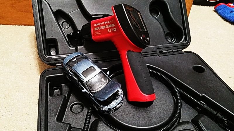

I am for [size=13px]using[/size] a high quality fuel suppliers recomend them and I do frequently check by [size=13px]scoping[/size] different parts of my engine to see what is going on and also what if anything using quality fuels, additives of other methods to reduce or eliminate carbon deposits on the intake induction system, [size=13px]combustion[/size] chambers and exhaust system.
