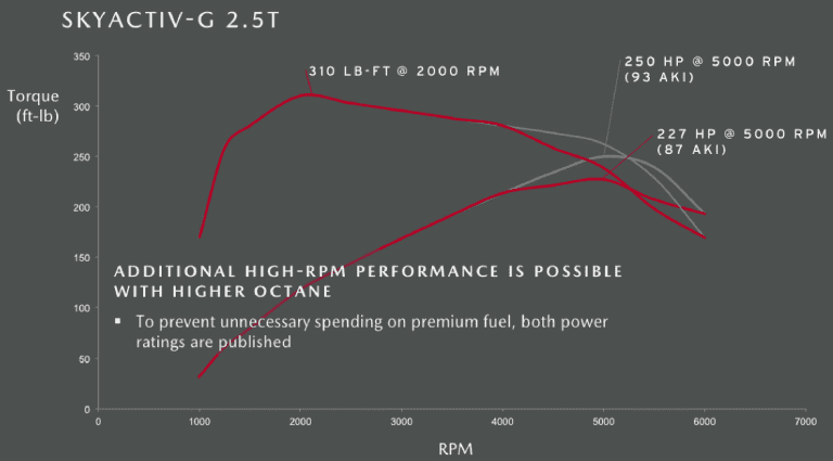

Read in some threads about how Sport Mode might work. So i contacted Mazda and they gave me the following info. Mine is a 2021 GTR, so YMMV."Thank you for contacting Mazda Customer Experience Center regarding the Sport mode on your vehicle.
I have been advised that the shift points move up to around 3k-4k RPM's depending on how much accelerator is applied. Sport mode does not allow for use of 6th gear. PCM prevents redlining and will automatically let off the gas or shift to higher gear if RPM's redline." I can confirm that in Sport Mode aggressive throttle moves the shift point up to above 5k.
They also sent me the attached.for further explanation on how the transmission shifts. I think some of this is in the owners manual? But it's nicely pdf'd here.

The chart is MAZDA's *claimed DYNO results not a transmission shift pint for sport or normal mode.
The sport mode is entertaining at best but most that know how to "sport" or drive spiritedly will turn off the stability and all proximity settings and manually shift the transmission.
And some will even re-mount the ECU upside down... (unless you know what I am talking about and plan to track race your MAZDA then disregard my mention of the ECU) LOL
As people get use to how their new MAZDA performs less will use the sport mode and more as I described.
I will note that in some situation there is some advantage to using sport mode for sustained normal and at times improved MPG, i.e. driving in San Francisco.
*power ratings from MAZDA are not certified and therefore they can post any figures for power their engines produce.
