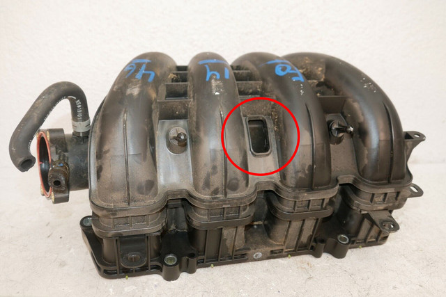

I went to look at a used CX-5 today. Overall, the vehicle is in good shape inside and out with a Carfax that shows 1 owner and oil changes done every 5k miles. However, when I pulled the engine cover I found a large amount of foam and what appeared to be some type of nut shells. I shined my flashlight around and found a rodent nest in the outer portion of the intake manifold. The void is filled with shredded foam that the critter(s) pulled from the intake manifold void, peanut shells, other bits of nuts, etc. I don't think the foam itself is particularly important, but I'm concerned about other potential issues. The dealership GM just shrugged at me when I mentioned it to him, so whatever lies ahead would be on me. Thoughts based on your experiences? Thanks.

Remove the foam clean it and carefully inspect the wire harness. There is relatively nothing that could be really harmed except the wire harness. But chances are because the rubberized foam would serve the rodents desire to nipple and make a mess you should be ok. It the wire harness had been compromised you would have surely by now had a DTC engine check light. As for the foam I am not 100% sure why it is there. Best guess is noise reduction. I removed mine about a year ago and did careful observation of IATs. Nothing changed. I am not sure if I even herd any increase in engine noise either?
No one seems to know why that foam is there, but it certainly seems to be unimportant.

AS I said examine the wire harness on the top area. I am sure that because of the easy access to chewing and building the nest the rodent confined to the foam in the intake and other nine auto related materiel's brought to the nest?
