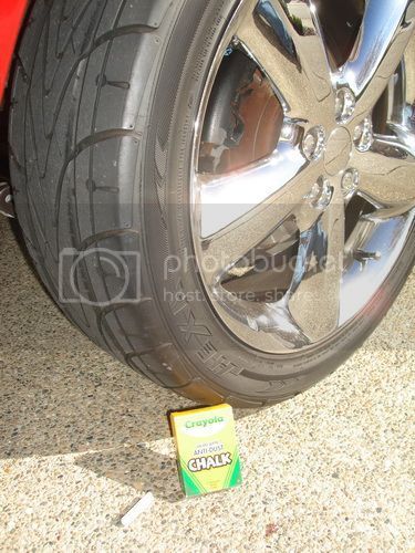

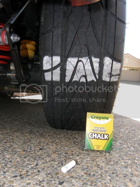

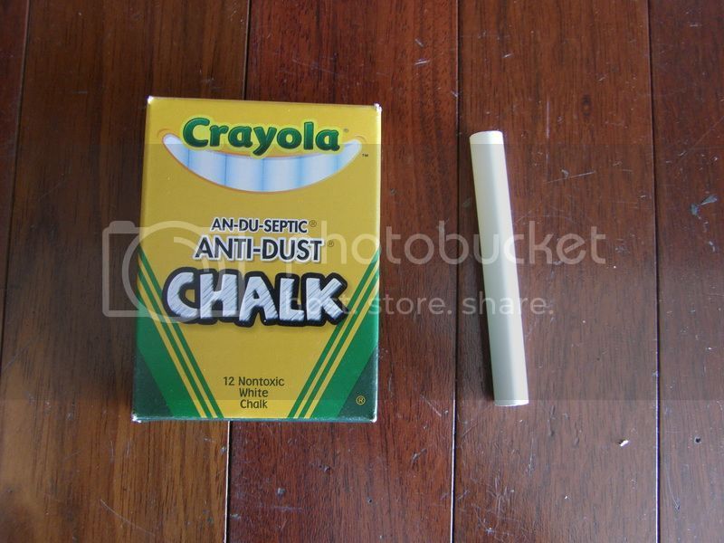

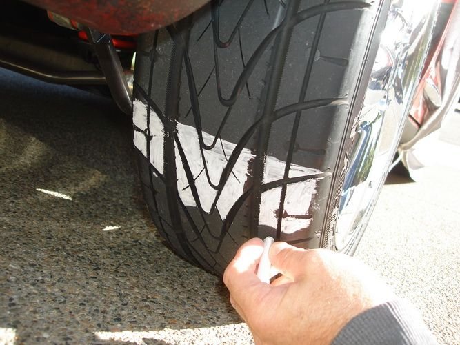

It is actually easy to see that what the auto manufacture recommends for a tire pressure is accurate on the tarmac. If you are using the correct best tire size for the wheel chalk can show you in only 25-75 miles what is going on with your alignment and the pressure chosen to adjust your tires to!
Adjust your tires as per the the recommend pressure in the owners handbook or the doorjamb of the vehicle. Then draw a solid chalk line across the width of the tire . Drive normally and occasionally have a look at how the chalk is clearing off.
Here are my really old pictures that I have used on forums for almost 2 decades. Unfortunately they are now water marked by photobucket . I am not going to dig out those old CD'c with the original picture I took to post unmarked pictures for this exercise on this thread. Sorry!
Front tire
Rear Tire

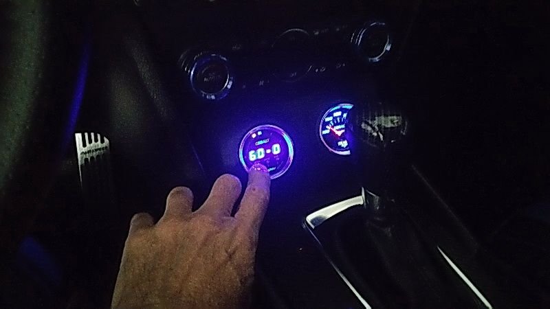

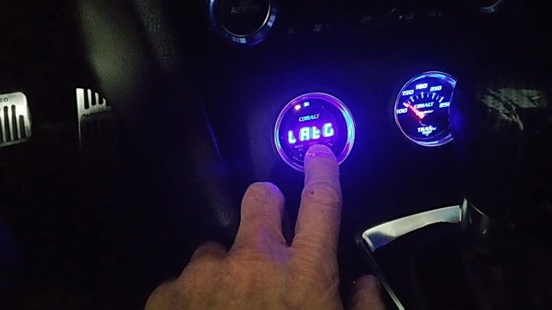

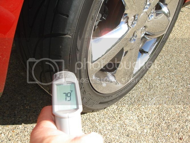

In another picture you can also check the tires operating temperatures and compare them to several values including road temperature and ambient to see how different tire pressure effect the temperature's. To high as well to low from recommended will increase the tires temperature during driving! This is yet another reason why we follow the recommend tire pressure.
The last item would be the safety measurement stopping. This you would need an accelerometer gauge. You can accurately measure the 60mpg to zero/stopped time and distance as well the lateral holding of the vehicle on a flat surface during hard steering. You can even measure the grip G-force of a tire and the chosen tire pressure . Tire pressure dramatically effects all 3 of these performance and safety aspects. So ya once again staying with the recommended tire pressure will give you the safest and best performance over choosing your own tire pressure to use!
