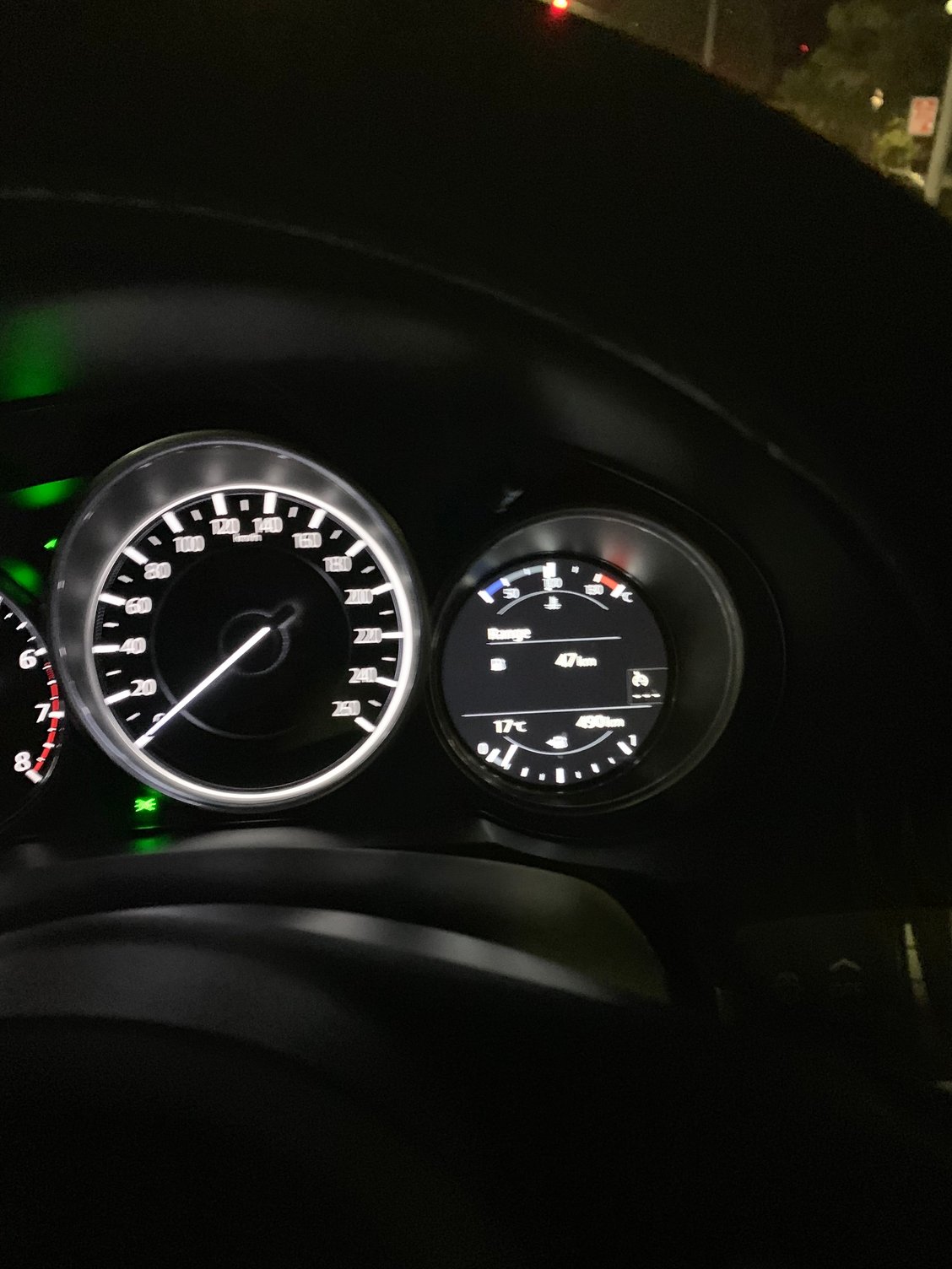

Old Sep 28, 2019 | 04:14 PM
Urgyen's Avatar
From: Zürich
Default Photos during full stop
Old Sep 28, 2019 | 09:43 PM
schmieg's Avatar
Joined: Oct 2015
Posts: 704
Likes: 9
From: Madeira, Ohio
Well, since on the first picture shows the tach, it's hard to say what's going on.
Old Sep 28, 2019 | 10:51 PM
Posts: 7,847
If your rev counter / tachometer doesn't go to ZERO when you come to a complete stop, then i-stop is not operating. Plain & simple.
