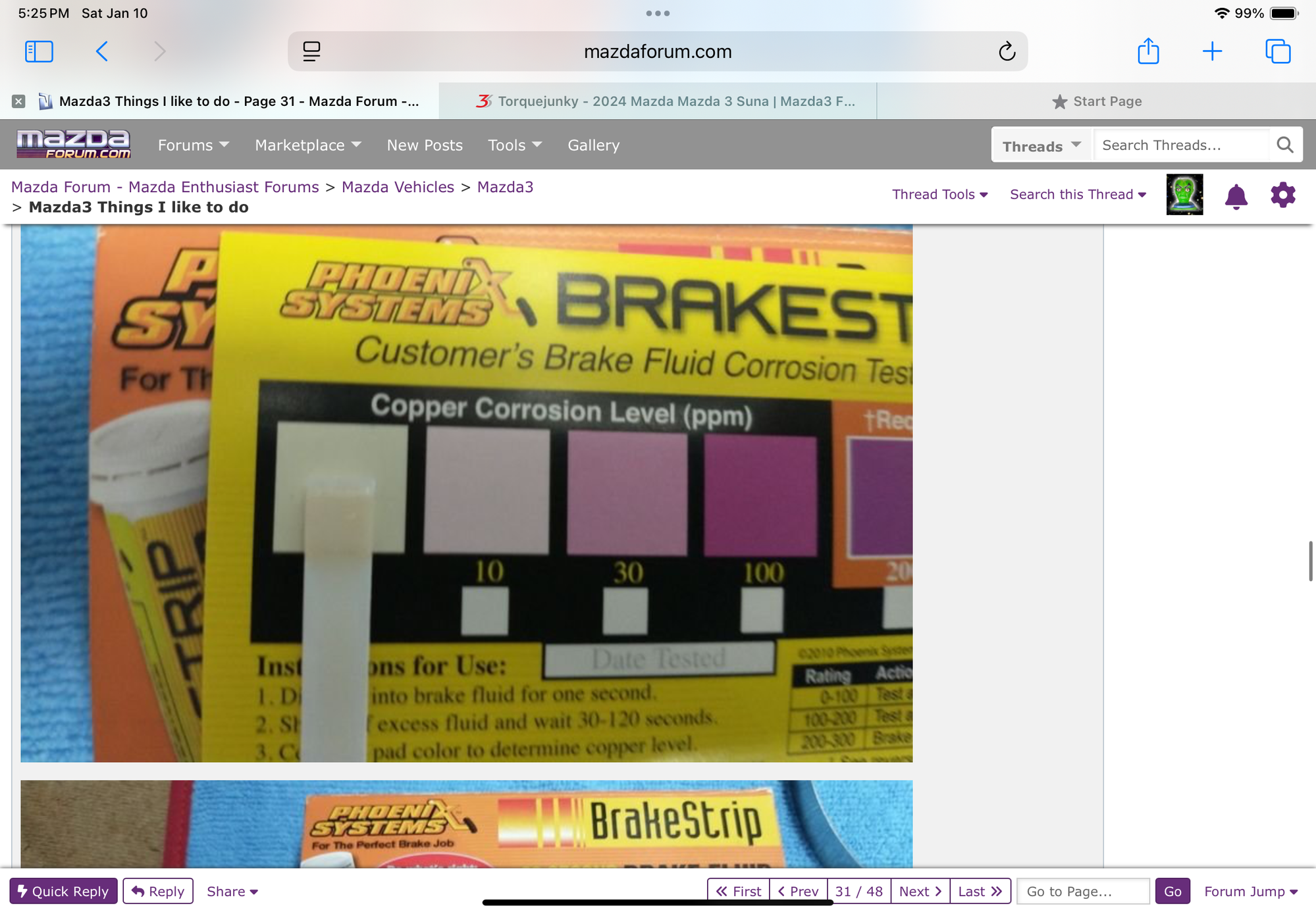

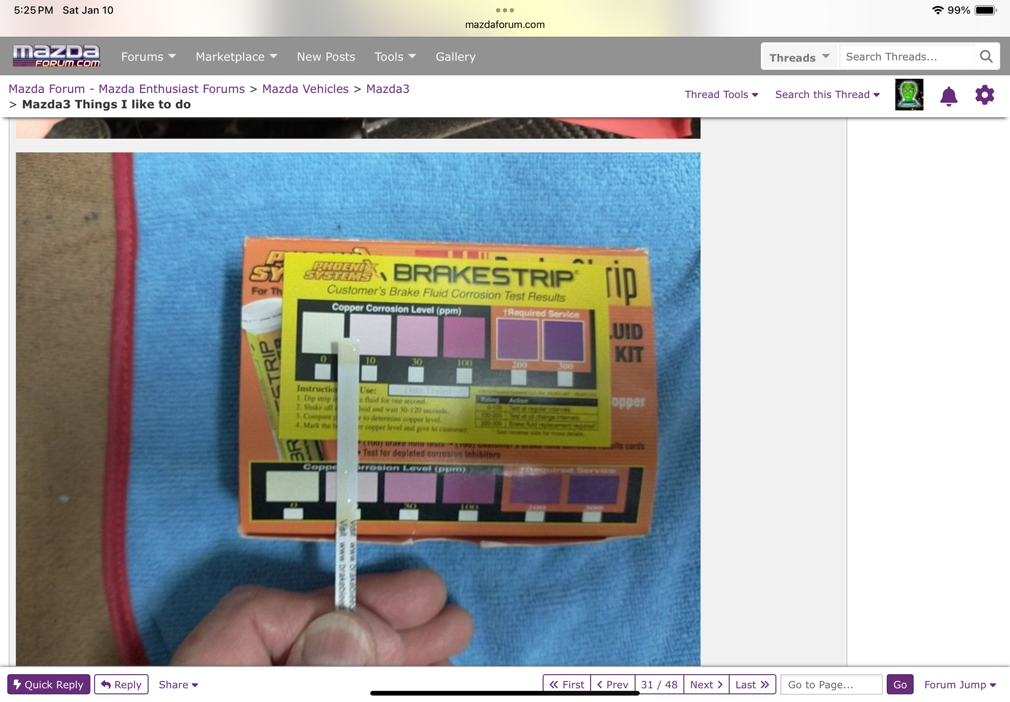

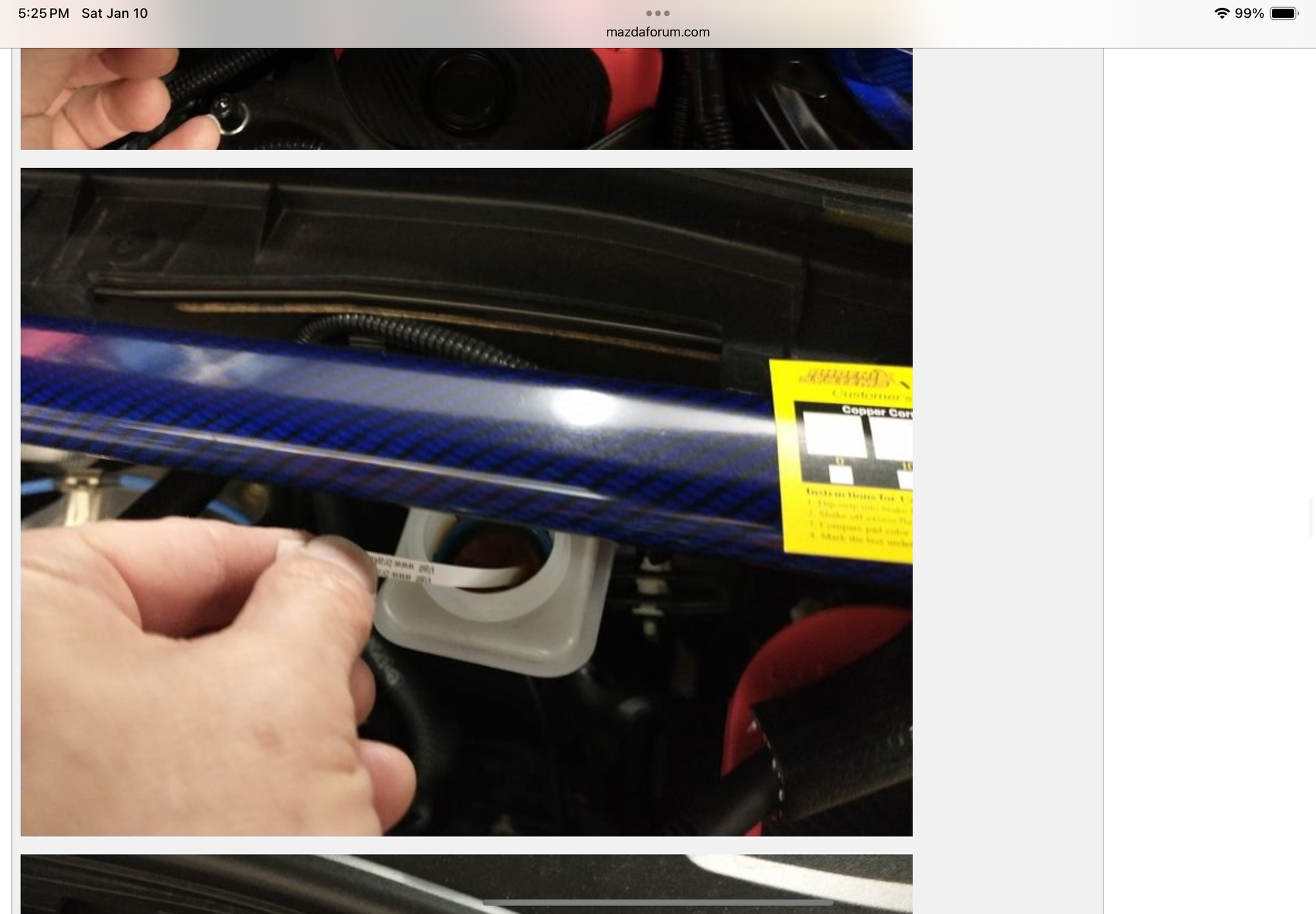

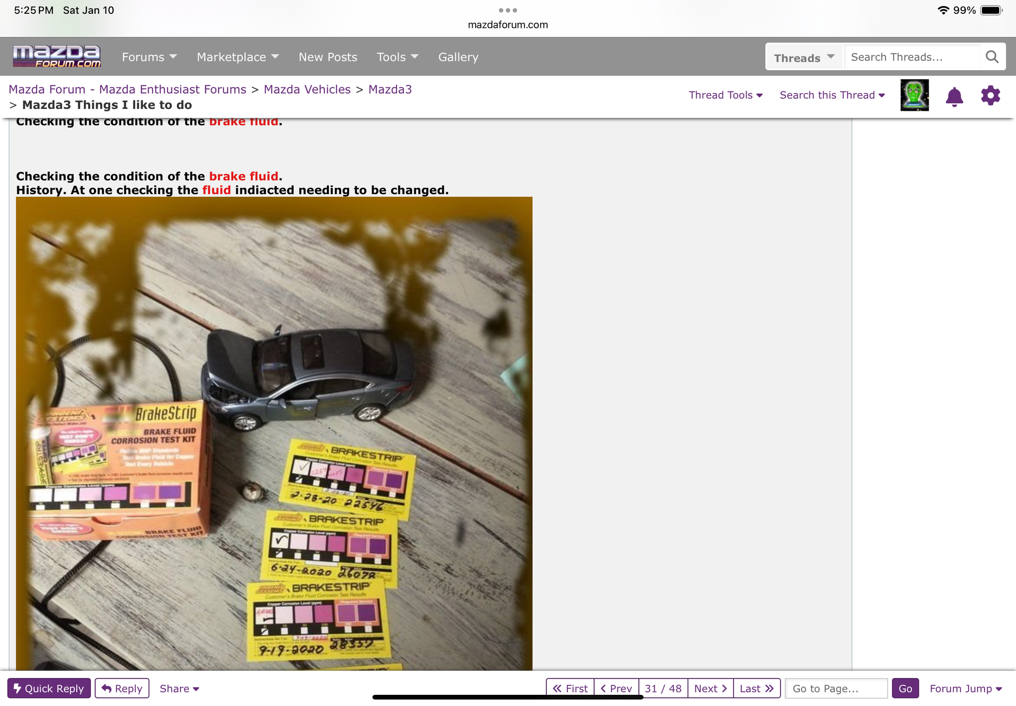

You should check it with the brake fluid test strips at least every 5 -7k miles. Very few people can really evaluate by the color of the brake fluid unless it is way over service time
