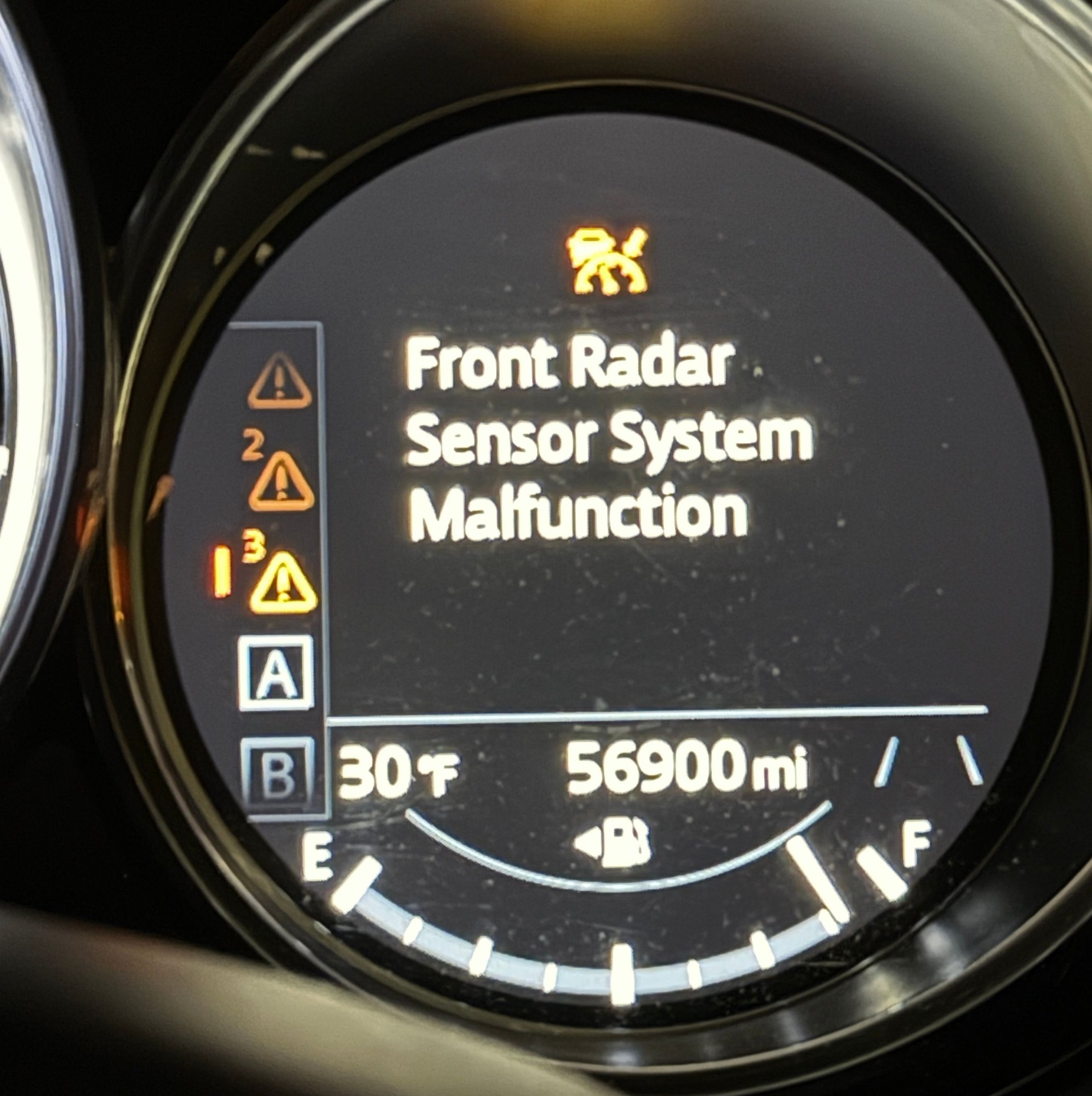

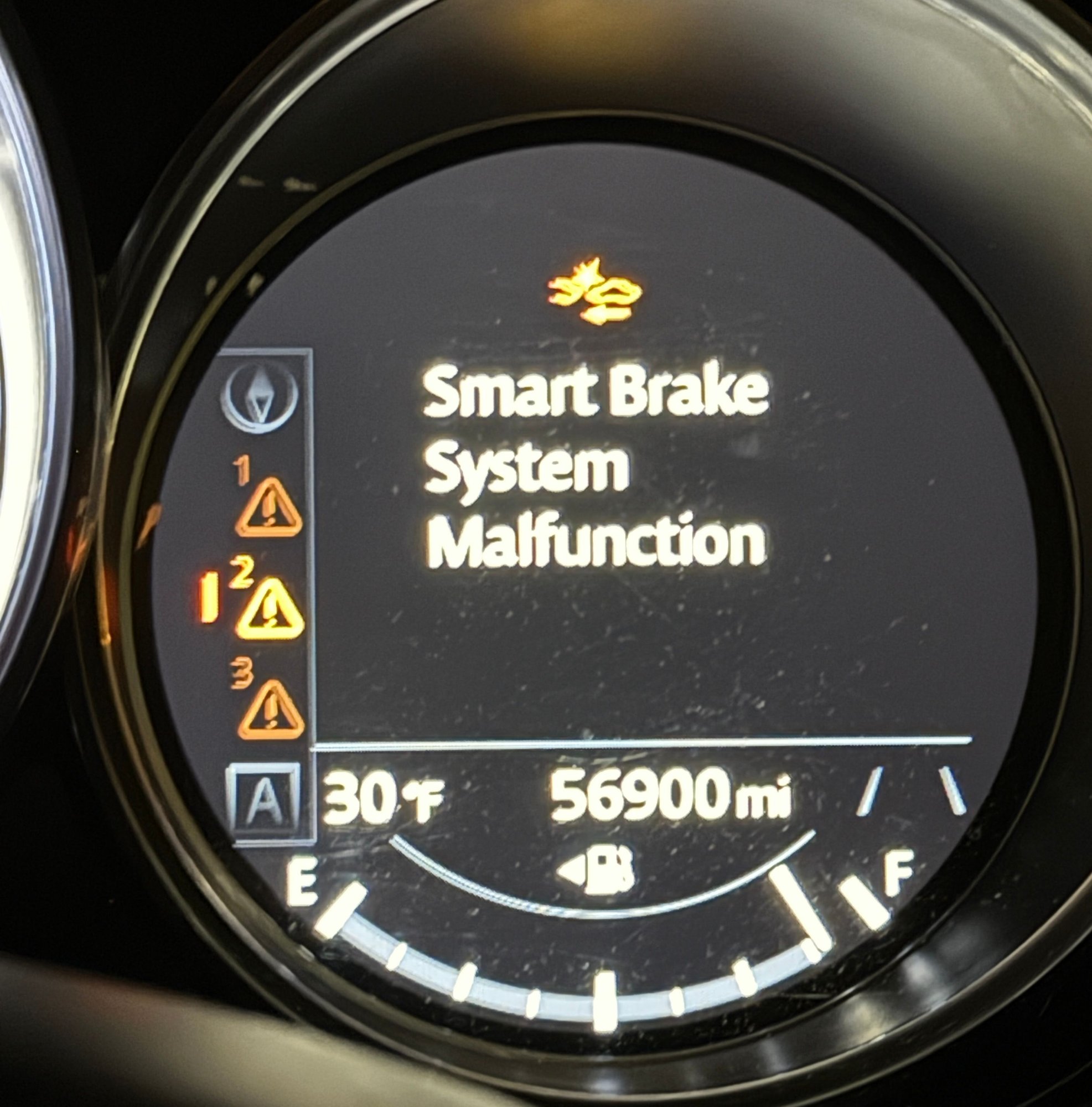

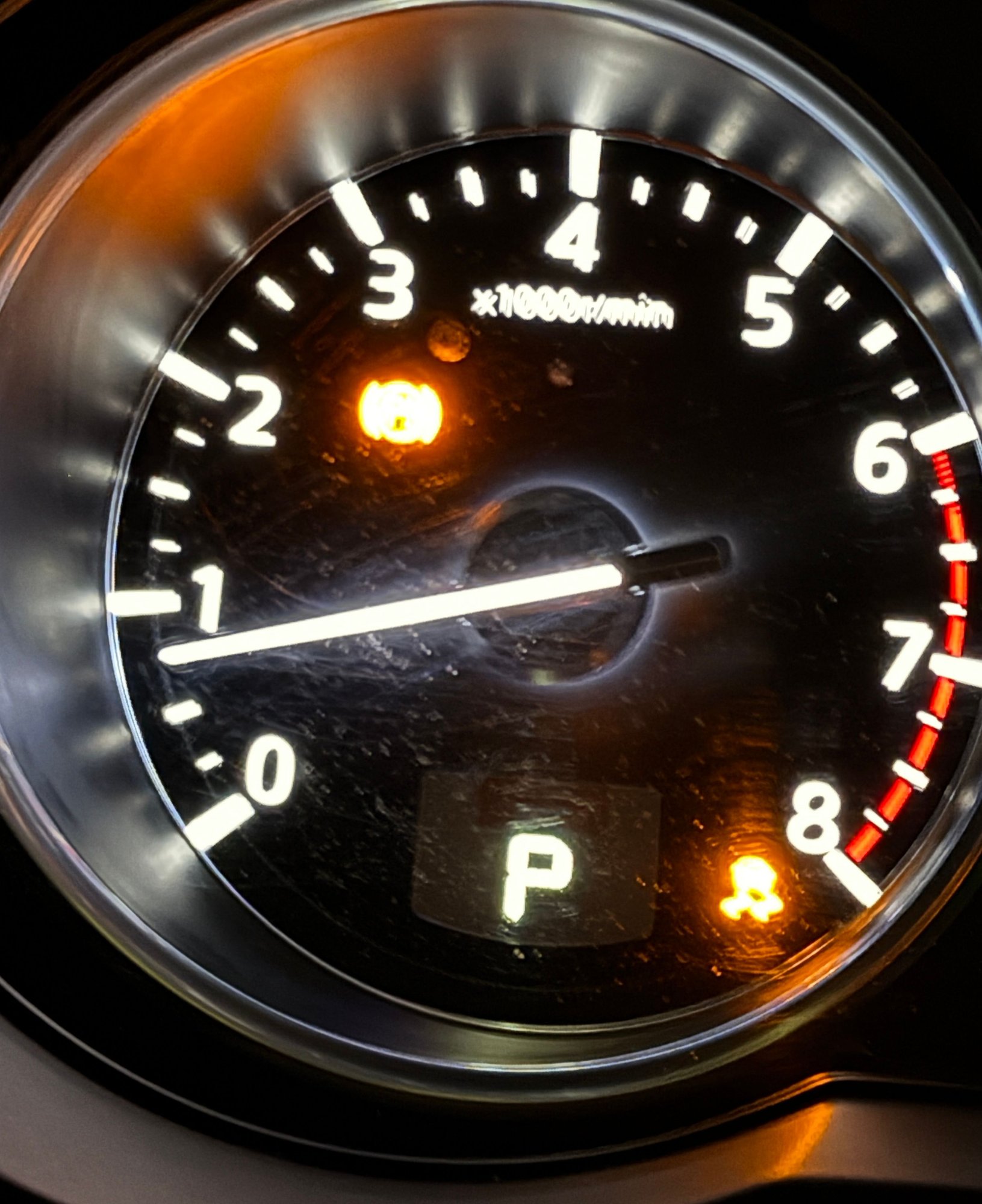

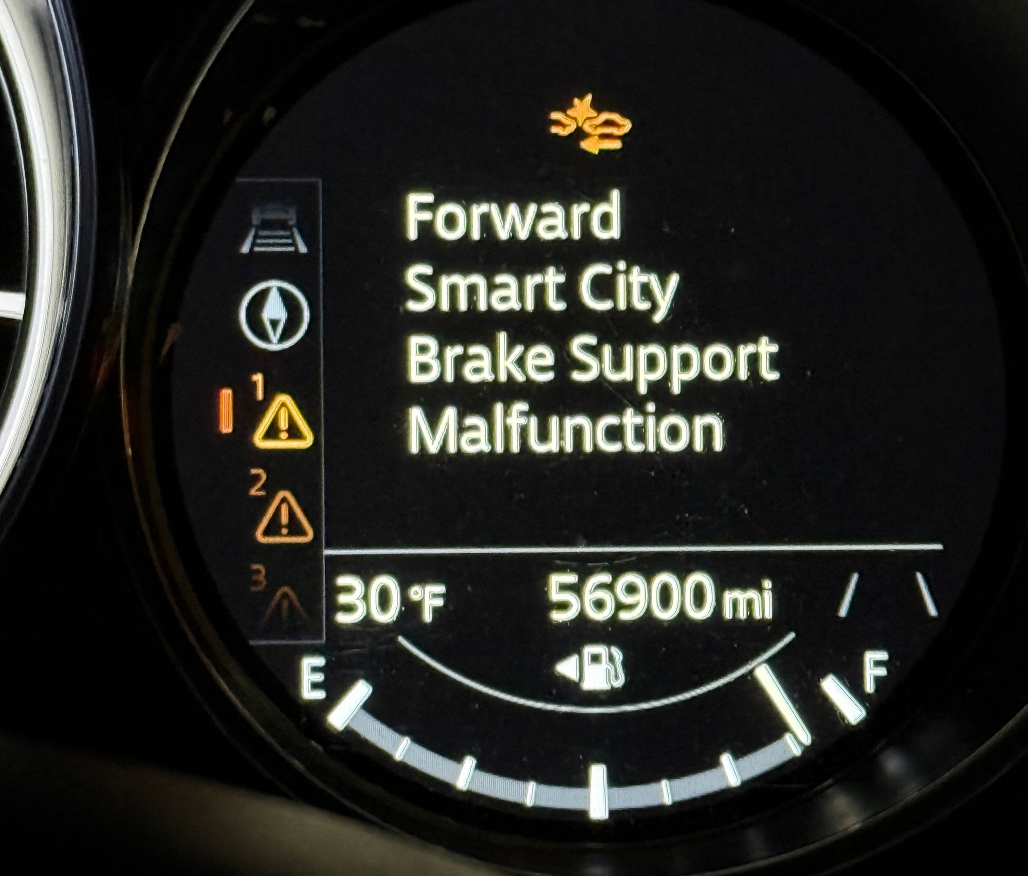

Hey everyone,
I started noticing today that my car started getting all these error codes that come and go away sporadically. We've been getting a lot really brutal cold weather up here in New England the last few weeks and my car is outside all the time. I'm leaning towards the battery going bad and will be replacing it tomorrow. I've got a 2021 so the battery is pushing 4.5+ years. Does this sound pretty likely to be the culprit?

My gut was telling me that the battery was starting to go, but I didn't notice anything out of the ordinary until this week. My instinct was spot on, and I'm getting it changed asap lol. My girlfriend's 2021 CX-5 battery was only getting 211 CCAs (cold cranking amps) towards the end of last year and we replaced it ahead of her move in October/November 2025. I figured that meant my battery was near the end too, and I'm glad it made it through the sub-zero degree farenheit weather we had the last two weeks!

I ended up grabbing an EverStart Platinum AGM battery from Walmart. It's a direct fit, but the foam battery protector/insulator on the old OEM factory battery that slides over it is a little bit too tall. I ended up having to bend it inwards (it's just thin plastic with little foam) and the positive terminal was able to go over with no problem. EverStart includes a plastic tray that you can snap under the battery to extend its height, but the J-hooks used to secure the battery in place on the sides are too short so I left the height extender off. I also used some battery dielectric grease on the terminals of the car and battery posts. Car started up no issue, but I had to cycle it a couple of times along with erasing the computer with my OBDII reader (even though there were none stored) to get the lights to go off. I'm gonna be taking a buddy of mine to look at a CPO Honda tomorrow since his Jeep is crawling to the finish line, so I hope all that driving will help my car re-learn everything.
