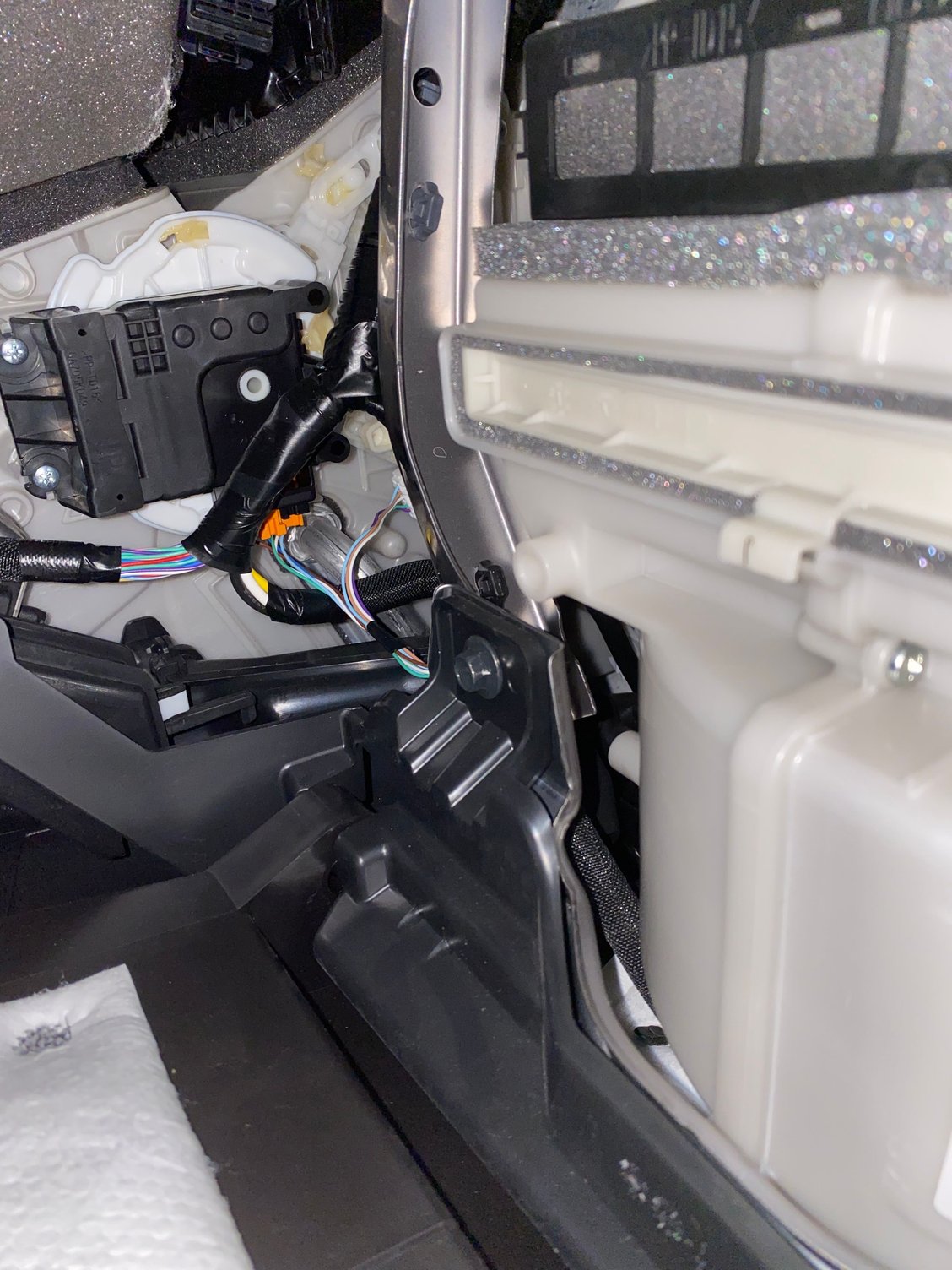

Old Apr 16, 2022 | 05:44 PM
Charly2020!'s Avatar
Joined: Apr 2022
From: Toronto
Originally Posted by Mazdaon
I'd hope you're OK, do you have front and rear park sensors? or did they installed at dealer?. The fuse that supply power to the park assist unit is the ignition relay IG1, so that is not an option.
You could remove the connector from the module until all repairs are done, it's located behind glove compartment in 2017-2020, not sure in a 2021 model. Pull glove compartment stay damper in this direction ----> then press both ends of the compartment, keep lowering it until hooks pass the frame and remove it, take a peek.
hi again @Mazdaon I took another shot and got a flash light this time. I found the following (see image below). Can you please confirm if this is what you are talking about?
Old Apr 16, 2022 | 08:28 PM
Mazdaon's Avatar
Joined: Jun 2021
Posts: 161
Likes: 4
From: FL
That's TAU (tuner). Have you look above tuner?

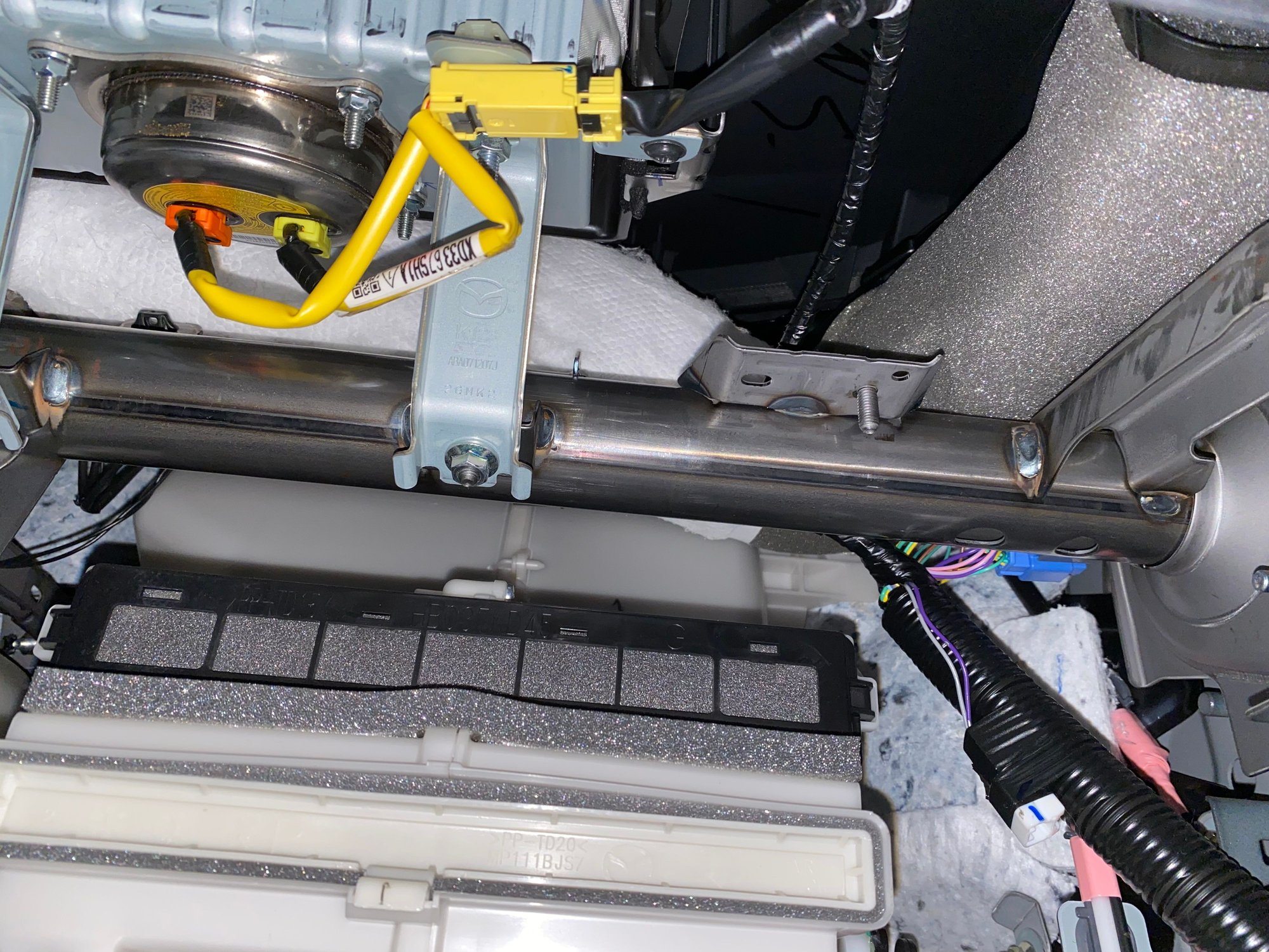

Old Apr 18, 2022 | 10:53 AM
Joined: Apr 2022
From: Toronto
@Mazdaon I did and this is what I see behind the glove box. Please advise.
Old Apr 18, 2022 | 01:44 PM
Mazdaon's Avatar
Joined: Jun 2021
Posts: 161
Likes: 4
From: FL
Nope is not there. Here's the deal, Mazda redesigned wiring in '21 and I haven't seen any diagrams. There's even a difference between Canada and US for example TAU is not there anymore in the US it's a Remote Tuner and probably located in the trunk area closer to the antenna.
BTW nice pictures, device with yellow/orange connectors it's passenger air bag, be careful.
Sorry I'm afraid I can't help you I don't have any other info.
