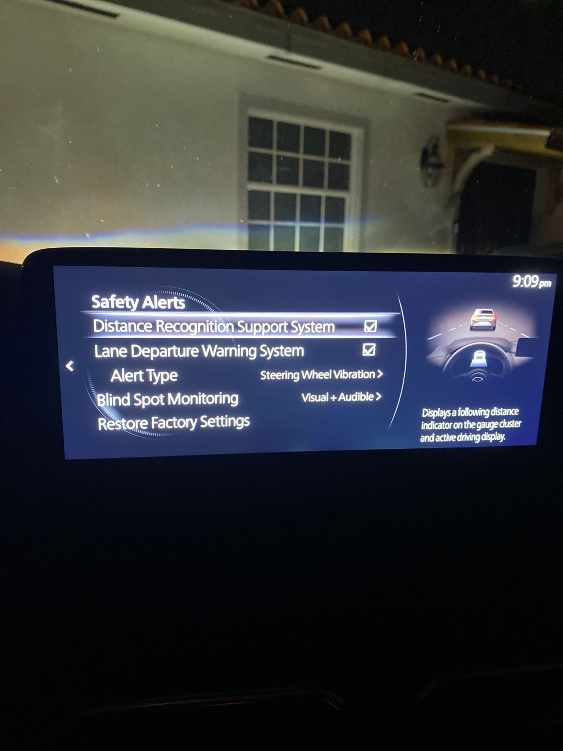

It just a started to happen that neither the collision avoidance or lane keep assist works. No errors on the dash. It’s a Mazda CX-5 2021 Sport

Most likely this is due to an inadvertent operation of the LAS/LDWS button. Your owners manual describes this.

Everything seems to be just fine. It just doesn’t work anymore

All settings are ok

Try to hit "Reset Factory Settings" , then restart car, now it should work :-)
