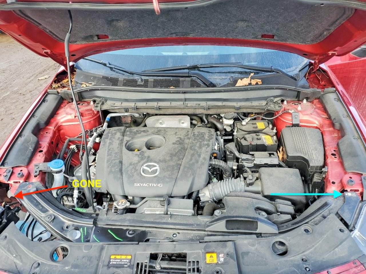

Good day,
I can't to identify which type of headlight installed in CX5 2024 Preferred. Can you help me? )) Mazda oem catalogue give 2 options with and without adaptive light. But I don't know what type where isntalled before collision ) And can't to ceck by VIN code.
VIN JM3KFBCL4R0485708
Thanks in advance.

From my research, the S Preferred does not come with adaptive headlight only the 2.5S Premium and higher trim levels do.
You need the parts w/o adaptive light.
Though to be absolutely certain you should call your local Mazda dealer and verify this.

Open the hood, headlight assembly part number and the other relevant info are printed on a label, left and right of the engine bay. Your right side label is no longer there, but it can be figured out from the left side part number. Best of luck with your project.
Thank you for the advice. I just hoped to find out which one I have to order in advance, before I get it in port of arrival. Because of will need to repair somehow and make a trip along 1200 km ) Also here is no any local dealer in my country that can to help. Any way it's good news that I can find part No on the part at least. )_

Wow …someone really needs to clean the engine bay…
it's pic. from copart )

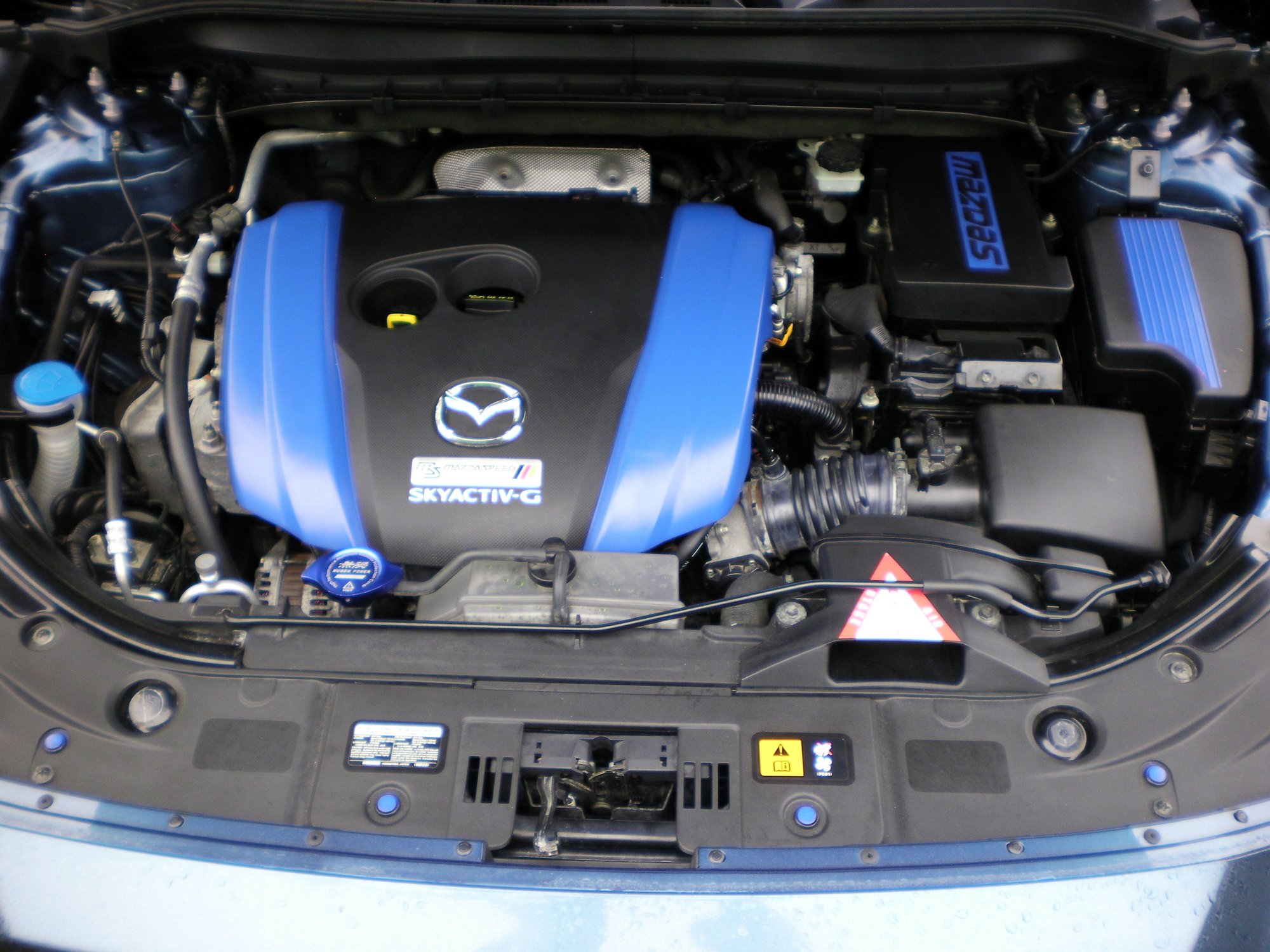

This is how it should look...
