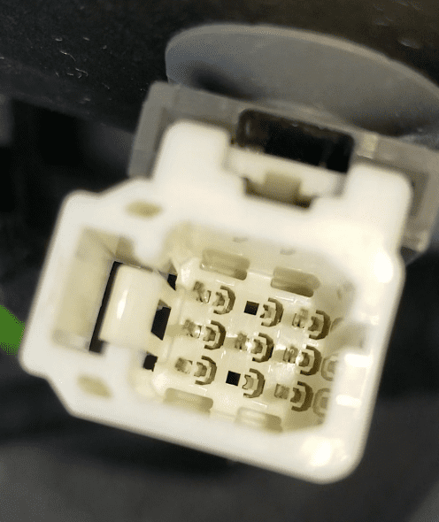

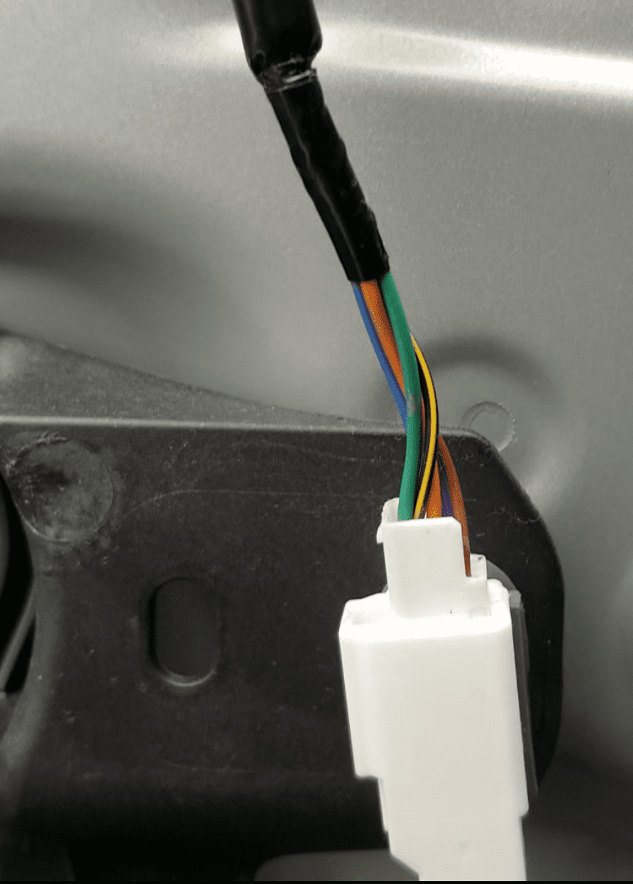

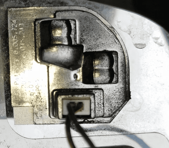

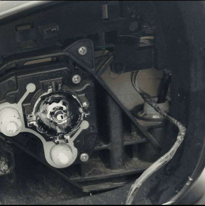

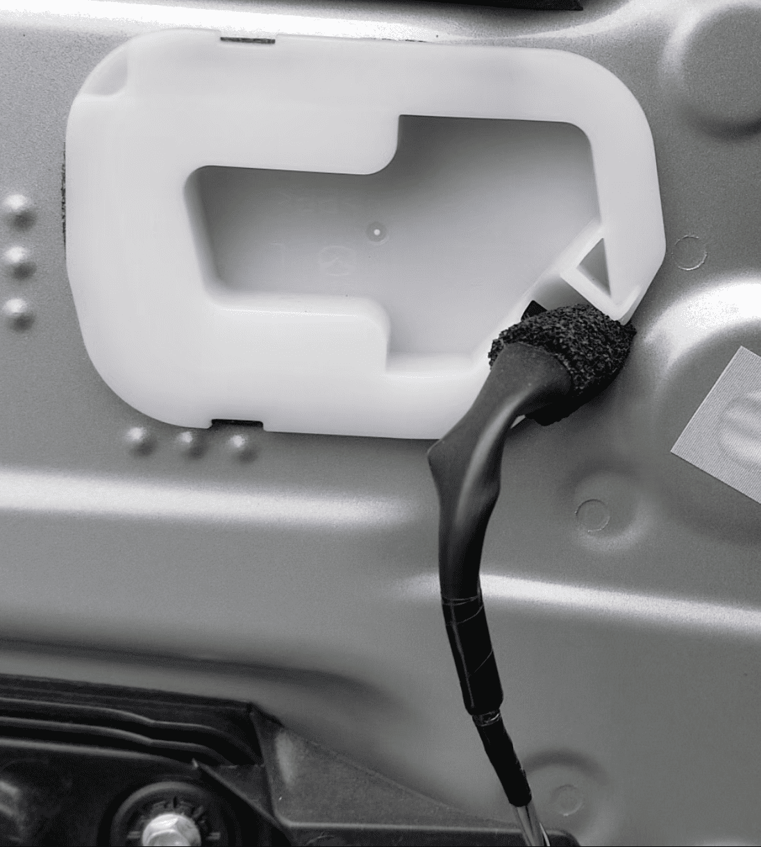

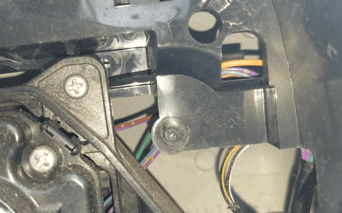

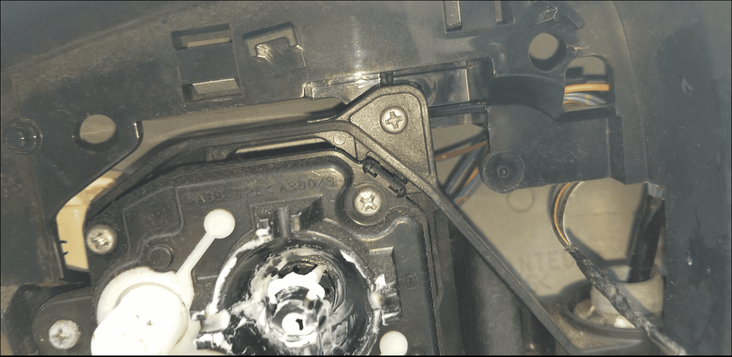

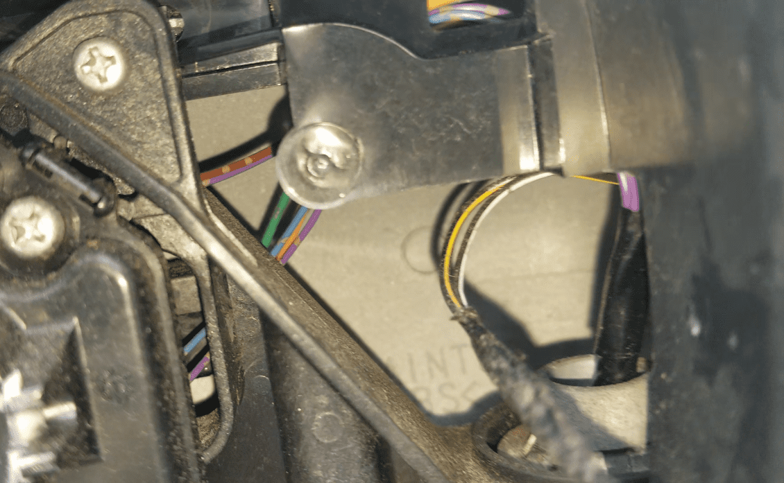

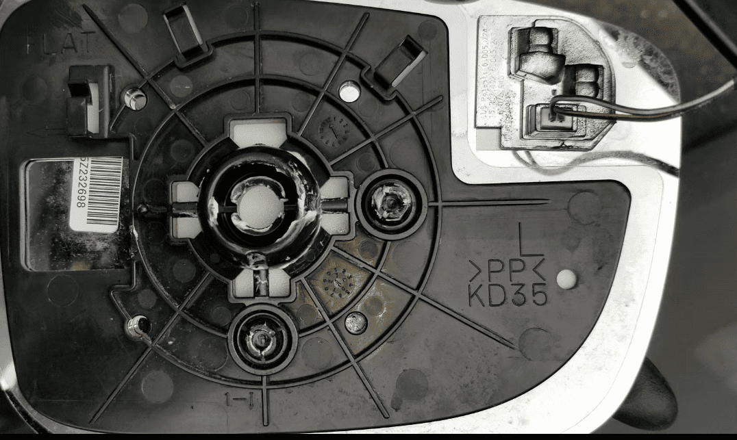

Okay, so I decided to take apart my CX-5 today, especially the front door trims and also the the mirror glass. Based on what I found, I don't think that the door is pre-wired for heated mirrors and it looks like the wiring harness that leads from the engine area to the door is something that would need to be replaced completely in order for heated mirrors to even take place. Take a look at the pics and let me know what you guys think:
Mirror housing wiring:
Has anyone installed heated mirrors on their 2016/2016.5?-1599764062785.png
Has anyone installed heated mirrors on their 2016/2016.5?-1599764085552.png
Wiring
Pins:
Has anyone installed heated mirrors on their 2016/2016.5?-1599764220097.png
Back of mirror (Blindspot monitoring with no heat):
Has anyone installed heated mirrors on their 2016/2016.5?-1599764301623.png
Two pin connector:

Inside the mirror housing assembly:
Has anyone installed heated mirrors on their 2016/2016.5?-1599764367010.png
Has anyone installed heated mirrors on their 2016/2016.5?-1599764382874.pngHas anyone installed heated mirrors on their 2016/2016.5?-1599764395788.png
Has anyone installed heated mirrors on their 2016/2016.5?-1599764409230.png
Wiring
Pins:
Two pin connector:
