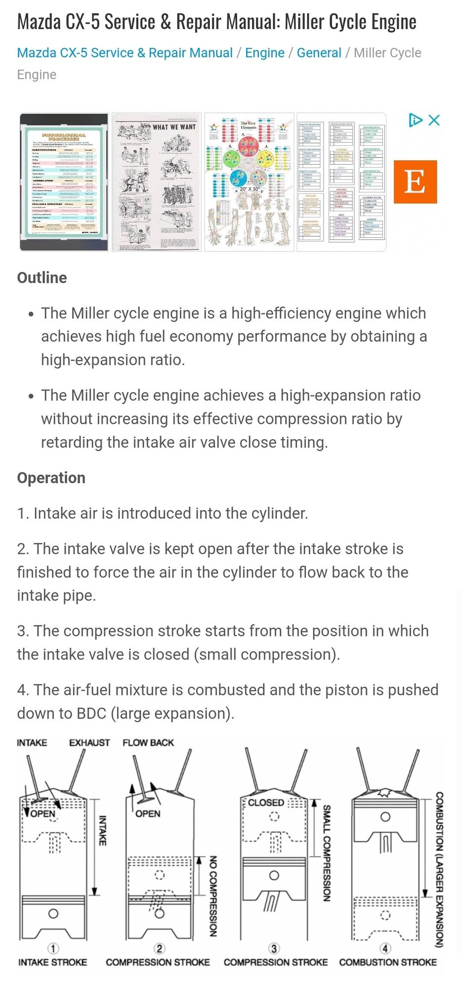

Found this explanation in the manual for the miller cycle and variable compression of the skyactive engine. When you run 87 octane gas your intake valves stay open longer to reduce compression ratio so your engine does not blow up. It also makes an annoying Baaawaaaaahhhhh sound when you try to accelerate. That is one of my favorite benifits of running a ~E20 mixture. The engine is silent, and has more torque during daily driving.

ITRW (in the real world) if you have a good ECU calibration improved cams from OEM and a couple other "secret" go fast parts (for N/A) there is no sound except the noise made by the tires hazing during hard acceleration and holding the steering straight because of the torque steer that Mazda claims is not there on newer model Mazda's yet I found that to be defined as those that drive average DD style. LOL
