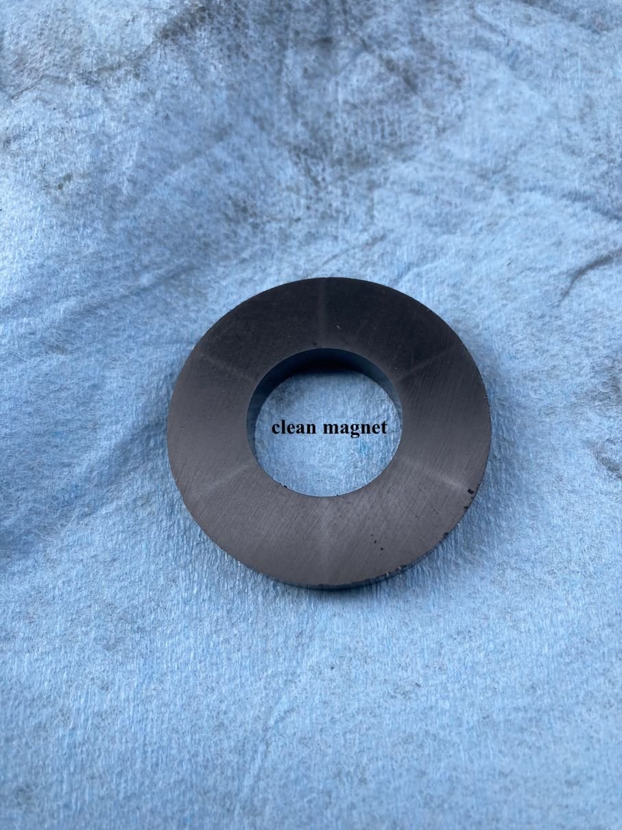

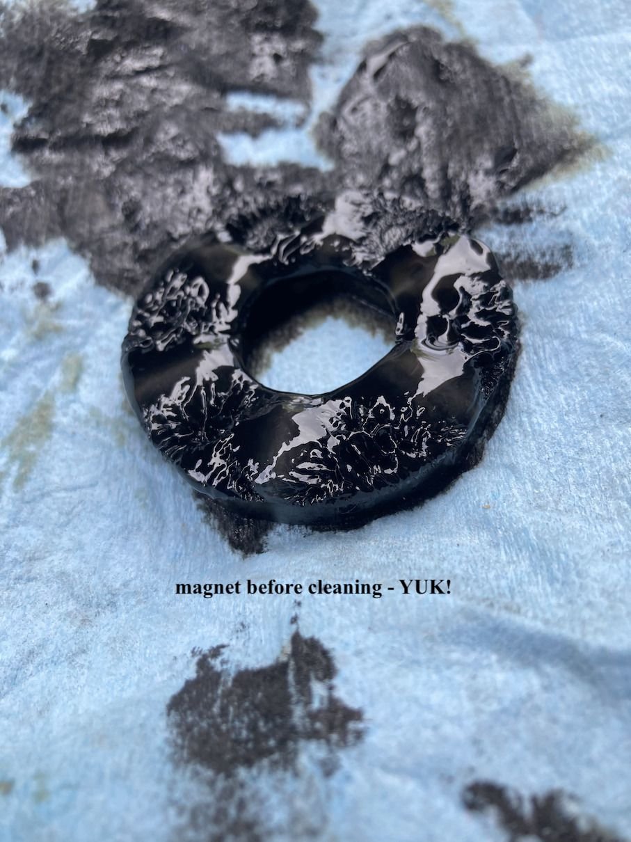

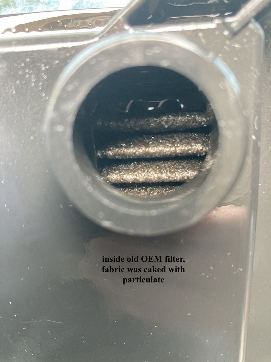

Default Changed my transmission ATF and Filter
2020 CX-5, 6 speed automatic, 2.5 L SKYACTIVE, no turbo
Since my last inquiry post, today was finally change the ATF and filter day due to the arrival of cooperative weather.
  • Vehicle at 94,300 KMs = 56,600 miles
  • I believe first ATF change for the vehicle, I ignore the fallacy of “lifetime” fluids; when I simply inquired about Mazda ATF and filter pricing, I was firmly told by a Mazda dealership “You never need to change the filter or the fluid, I can’t even price the filter, it’s not in our system.”
Observations of the project:
  • OEM fluid was cooked black, drained 4.2 litres = 4.4 quarts leaving about 3.5 L = 3.7 quarts remaining in system.
  • Inspecting pan, it is in excellent condition, no corrosion or blemishes.
  • All 16 of the pan bolts loosened nicely and were removed with ease; there’s often “that one bolt” isn’t there? but, thankfully not in this case.
  • 15 of the 16 bolts were in pristine silver condition, I was pleasantly surprised; a single bolt was blackened with some rust and gunk and I was concerned, but it did remove easily.
  • The most challenging part was separating the pan from the transmission due to the Mazda OEM sealant, no gasket here; careful and patient prying with nylon pry tools worked.
  • I concentrated on the right front corner of the pan as it has the most access. Once it separated, I could wedge in another nylon shim. Sliding another nylon tool along the length, and suddenly the whole pan released.
  • Collector magnet had the thickest layer of particle gunk I’ve ever seen.
  • Interior filter, which is not just a “metal strainer” as some say, has a fabric insert, was clearly visible and loaded with filtered particulate.
  • Original plan was to utilize a rubber gasket instead of sealant. Alas, the gasket kits ordered from Amazon were incompatible. Filters were fine, perfect fit, but the gaskets were not. Almost half the bolt holes were misaligned. A couple by half inch. So, I used Permtatex Red gasket maker, high temp and does not degrade with fluids.
  • Utilizing nylon scrapers and a fine brass wire “toothbrush”, all residual OEM sealant was successfully removed from the pan and transmission housing. Took about 40 minutes. Again, patience here not gouge the pan or transmission surface.
  • Applied the red Permatex on the pan and reinstalled with bolts finger tight.
  • Waited one hour per instructions before torquing to 7.5 ft lb - easy with hand strength. Easy here, I believe the bolts are aluminum. Gradual tightening in a repeated star pattern until all snugged.
  • Now the waiting. Permatex instructions are to wait 24 hours for full sealant cure before refilling and operating. This is the part I wanted to avoid by using a rubber gasket. Not meant to be.
  • Refilled 4.2 L = 4.4 quarts of Castrol Transmax ATF, spec compatible with Mazda FZ and I bought for 60% less cost.
  • I plan two more drain and fills in about 1000 km = 600 miles each to purge more OEM ATF.
  • Future fluid changes will be around 60K kms = 36K miles.

GREAT write up and detail to the picture observation and conclusions!
