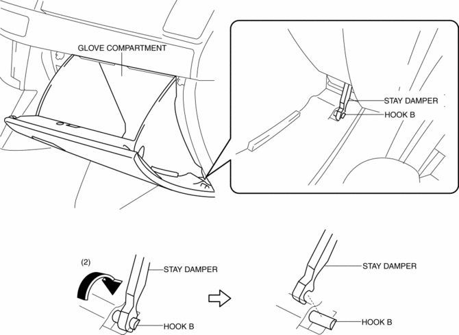

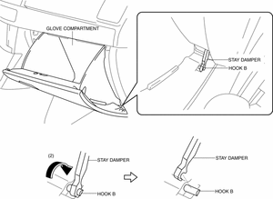

You're fine, it is a "stay" damper.
I can actually change the cabin filter in my 2020 without unhooking it.

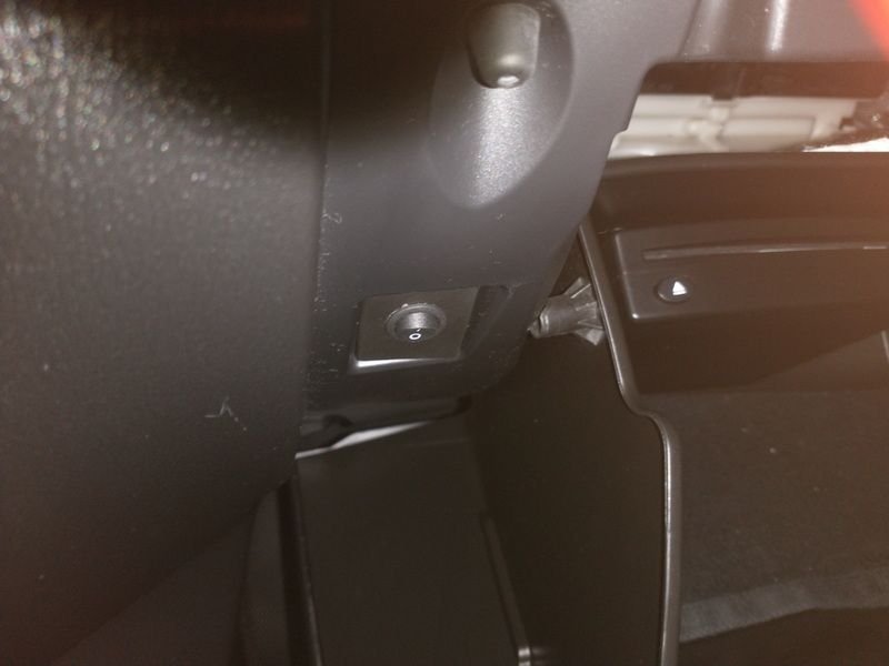

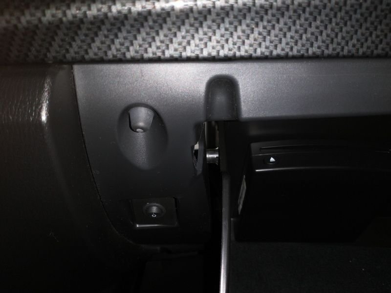

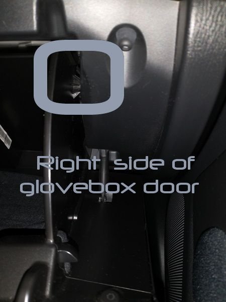

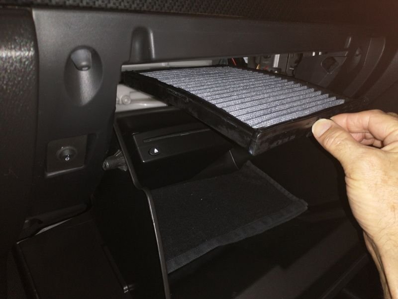

When you open the glove box there are 2 tabs at the top. In the picture I circled the right. There is also one on the left in the same position. You simply push gently on both side close to the tabs at the same pressure and time and the tabs will release and allow the door to drop enough to gain access to reaching in and pulling out the cabin filter. Once you have changed the filter then carefully and slowly close the door and the tab should reset easily. If there is too much resistance, then with one hand push gently on the close to the tab and it will go. When first doing this the tabs are very tight but after this procedure a couple of time and when you get acclimated to the procedure you can change the cabin filter from the driver seat in about 2 minutes.
Left glovebox tab
Right Glovebox tab
Left Glovebox tab
Cabin filter pulled slightly out for the picture reference of location
