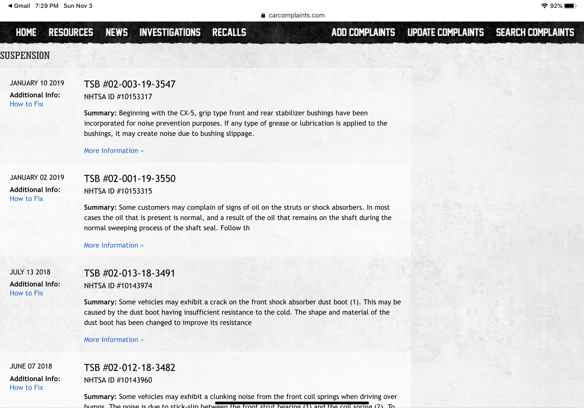

I have a 2017 CX5 AWD. Had a similar problem and took it to the dealer. There is a TSB for shock tower issue. I will see if I can find my paperwork.

Old Nov 3, 2019 | 06:30 PM
Arkainzeye's Avatar
Posts: 132
From: Pittsburgh, Pa
frogger
