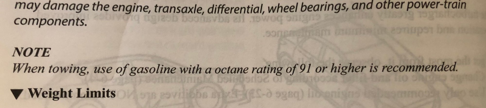

Mazda also recommends using 91+ octane when towing ? So wouldnt having a full 5 passengers and cargo be similar to towing ?
Max payload is about 850 pounds !
I would caution anyone with a skyactive engine to at LEAST USE 89 octane - and if you can go with 91+ - Once you stick with one octane your ECU will adapt and operate on memory unless a change is detected - but remember its difficult to know if 87 octane - (in which up to 10% can be enthanol ) is not 86 or lower - in which your ECU is not going to be capable of getting the engine to run properly !

That's a strange statement 95 or above and less than 98. Why not just say 95 or higher or are they concerned 98 and above may contain Ethanol?

Basic owners manuals are not always reviewed by Engineers before printing it generally editors looking for grammar flaws before final printing .So there is often some questionable info sometimes printed in the owners and even service information not just with Mazda.
For service manuals there are revisions or updates at time regarding some procedures and other service information .
They do not consider Gasoline formulas specifically if they may have Ethanol. If it were then you would see an asterisk with explanation information.
