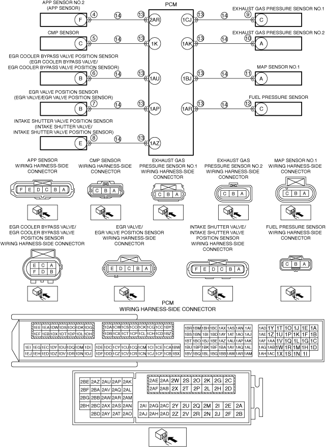

Hi, Does anyone know what circuits Sensor reference voltage B
supplies besides throttle pedal? I am showing short to ground at the pedal plug disconnected, I suspect other sensors on same line but cannot find.

Based on the code, i assume this is diesel engine?
DTC P0652:00 Constant voltage power supply control circuit low input
Spoiler
Vref = 5 V
There are many sensors that can affect Vref... unfortunately...
