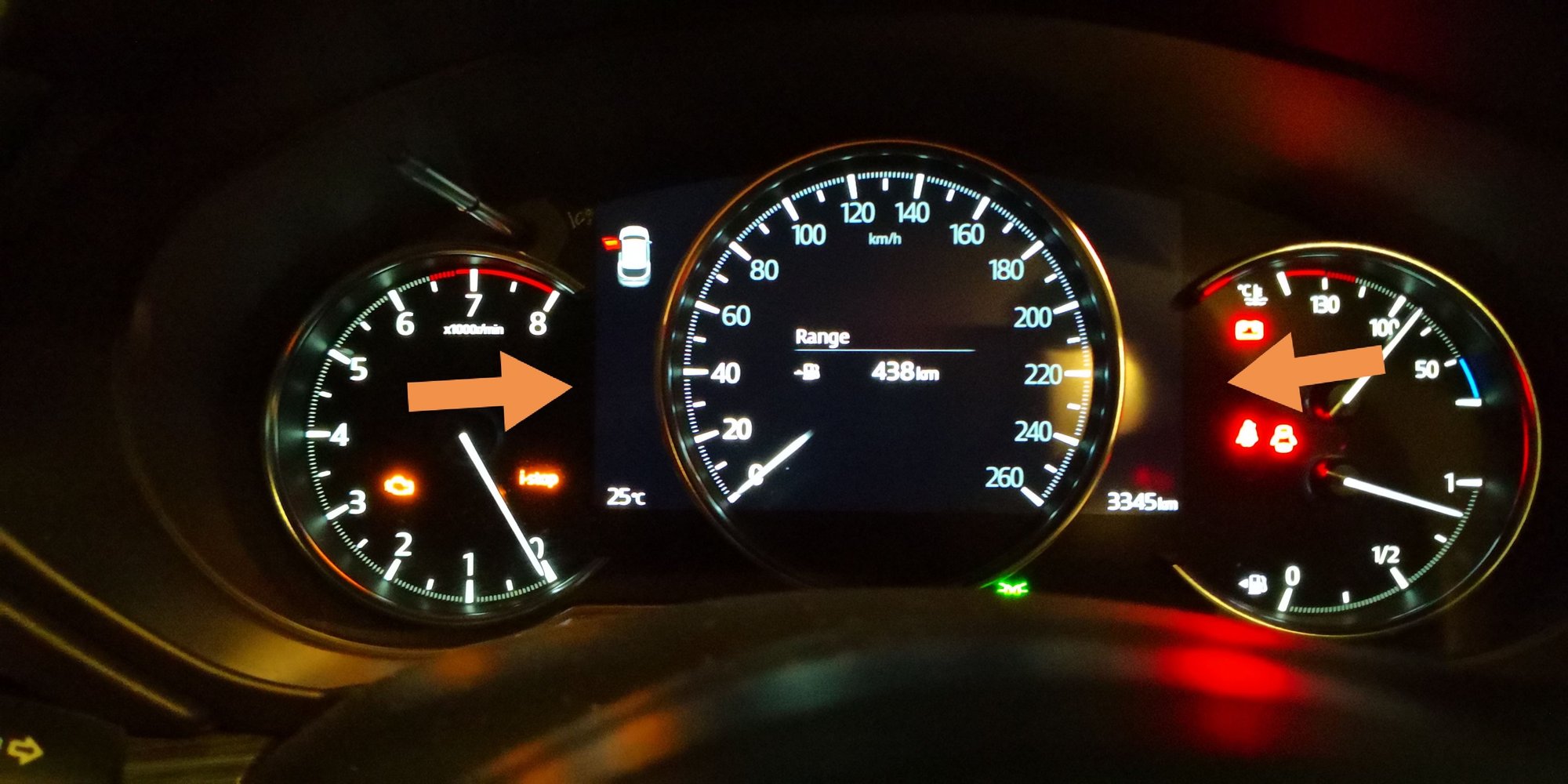

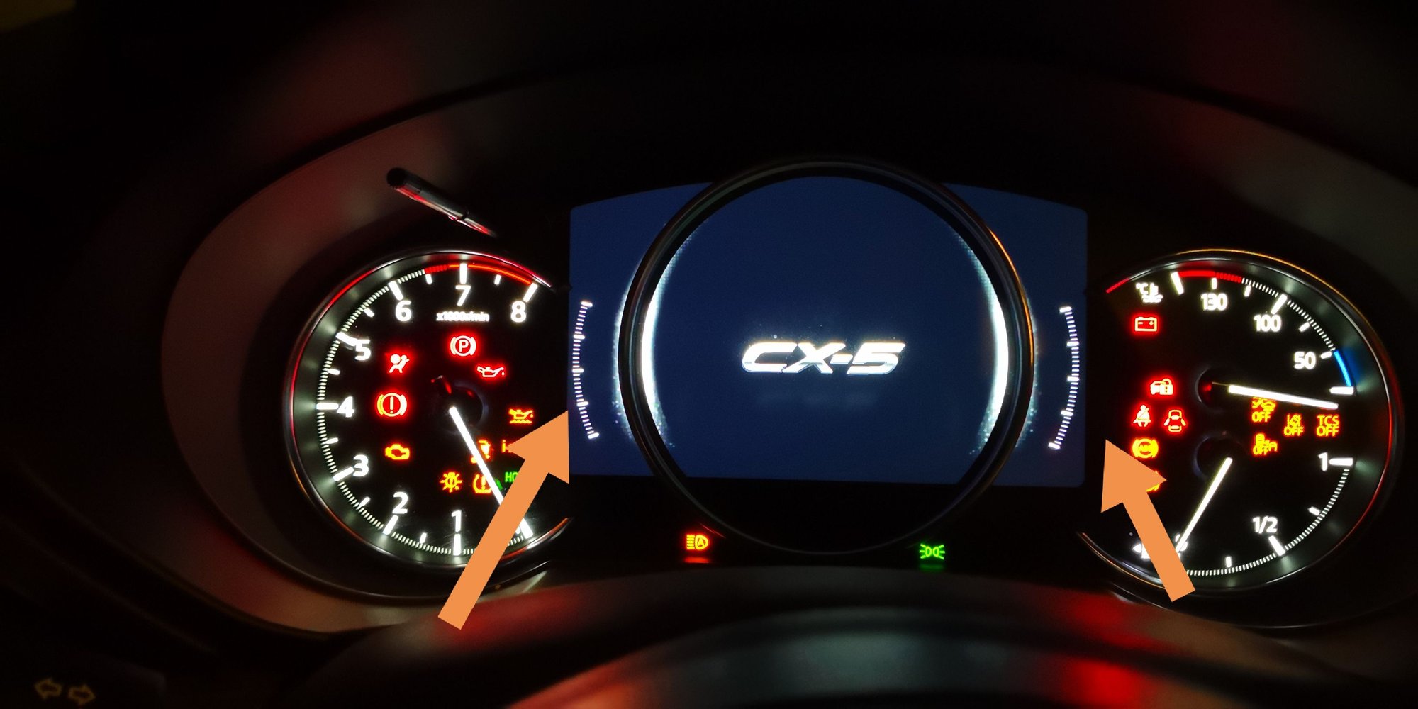

Here are some pics regarding the #1
Side indicators no longer there after the display loads completely.
