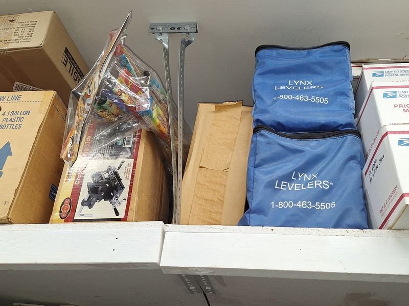

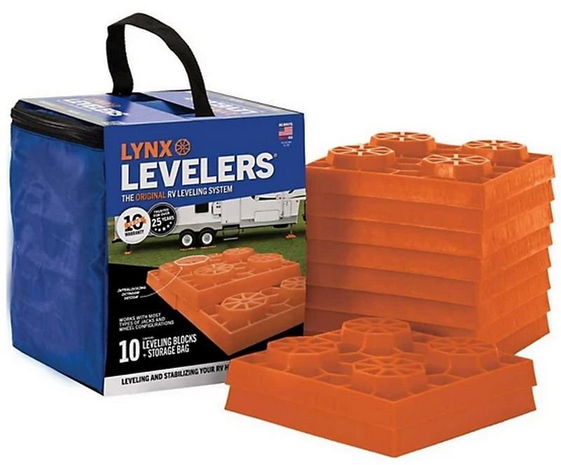

For DIY that want the absolute safest way and do not want to invest in a Quick Jack. These for motorhomes are by far the best investment you can make to work safely under your car or most trucks.
I also used these while storing a car off its wheels for over a year with no problems.
