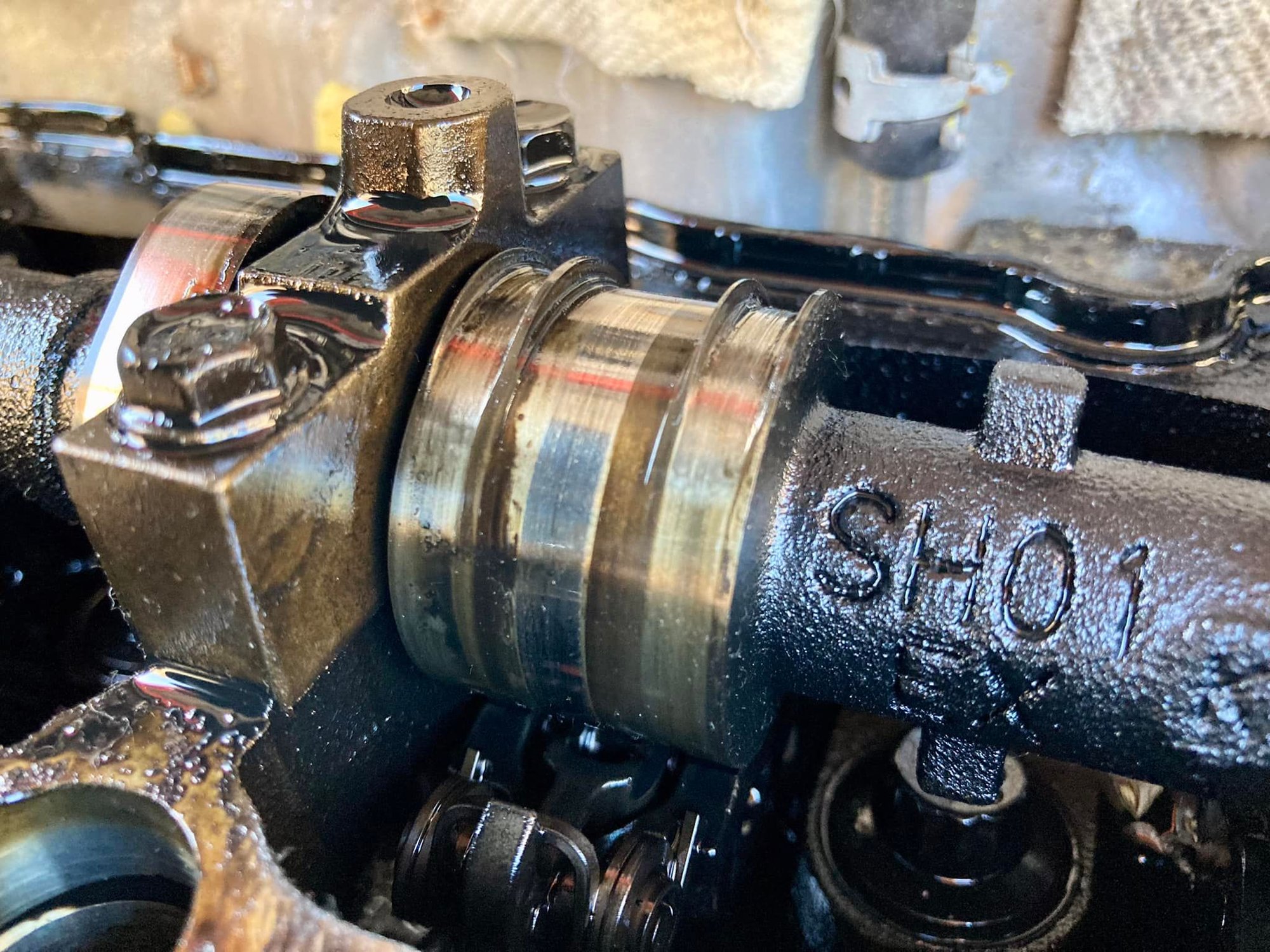

Old Mar 9, 2026 | 06:22 AM
  #38
Posts: 7,849
FYI early SH diesel engines had a lot of issues with excessive cam load wear.
Old Mar 9, 2026 | 08:43 AM
  #39
Posts: 10,726
Likes: 236
Good supportive picture of my explanation of camshaft composition and how a camshaft gets damaged or wear by the parts making contact with it and not the camshaft itself being defective in quality of the metal or the end grind of the product.
Yes, and in that picture it does clearly show that it was not caused from a defective cam but the design of the parts that the camshaft was run in. Looking at the camshaft "LOBE" to the left shows that which is what I was explaining in the last couple of responses.
So while the service problem description in the end may use the word "wear" it is cause and effect of bad engineering and not the actual camshafts fault
In the aftermarket world of camshaft if you purchased a camshaft and then attempted to return it as a defective camshaft and it looked like that exact picture you would be denied a refund or exchange. And the reason every time world be you have a problem with your head valve train components that the camshaft rune in or on not the camshaft. A metal hardest and or x-ray test would also confirm this.
The conclusion would be replacing the camshaft will only end in another camshaft being damaged and the problem not corrected causing the damage to the camshaft.
