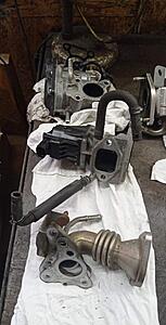

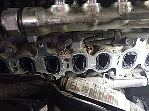

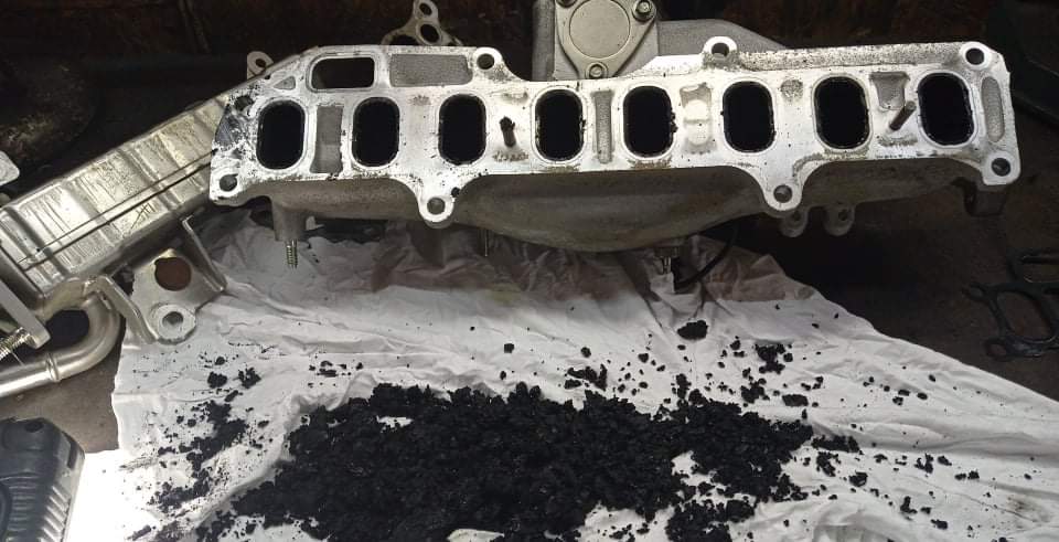

Question Multiple errors occurs on deaceleration
Anybody found solution for this issue?
I have the same problem with my mazda cx-5, 2016 2.2 D, AWD. Multiple errors occurs on deaceleration from 110-120km/h.
Engine goes to service mode. Mazda dealer asked 1300Eur to cleaning intake manifold, egr, Other service did jobe for less.
4 glases of carbon were discovered !! Unfortunately problem still left. Any ideas?

I have the same problems. The error code is P0101. Verify your turbo. I discover 2 days ago, that mine was broken, after I saw low level oil on the dipstick. Now I am waiting for the turbo to be repaired.
