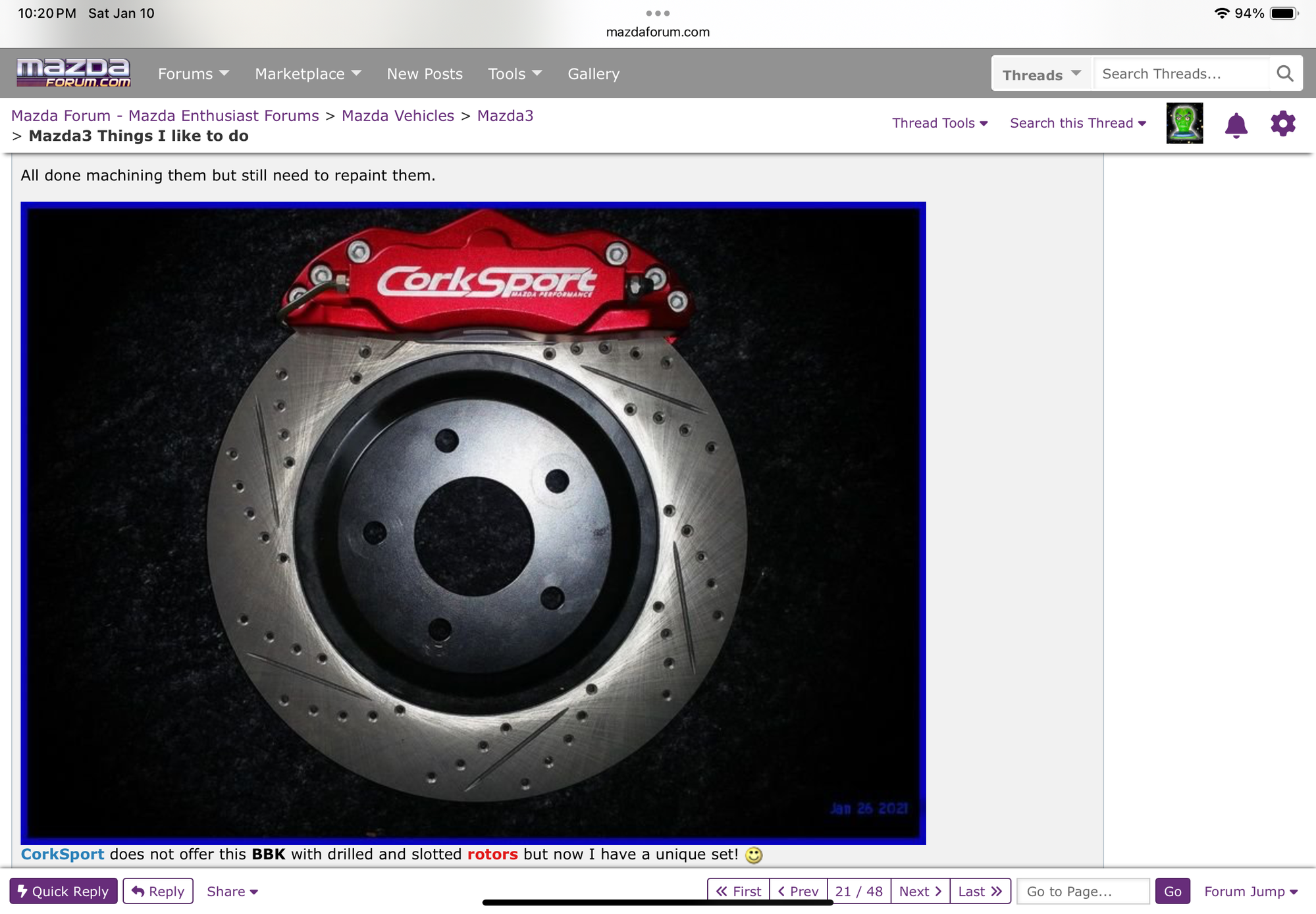

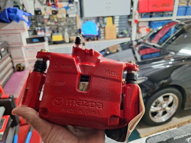

I engineer and design BBKs front and even for the rear on a couple platforms.
As for my Mazda ,even that I did some brake component mods to make them more pleasing for looks . In fact I will be doing a complete brake job in a couple of weeks that *will at least be disc and pads front and rear. Maybe a little more depends on if I have time and feel like it .But it’s time for pads a disc .
And yes a single replacement disc, for my BBK is $300 each.
I prefer and generally recommend Stop Tech discs
I also have installed a few sets of Cork Sport BBK front kits . They are great quality and competitive price for the kit. I have a set but have not yet installed it on my personal Mazda.
*I did have to upgrade the rotors to both drilled and slots for looks looks . And to match the rear discs
Here is some of my work.
