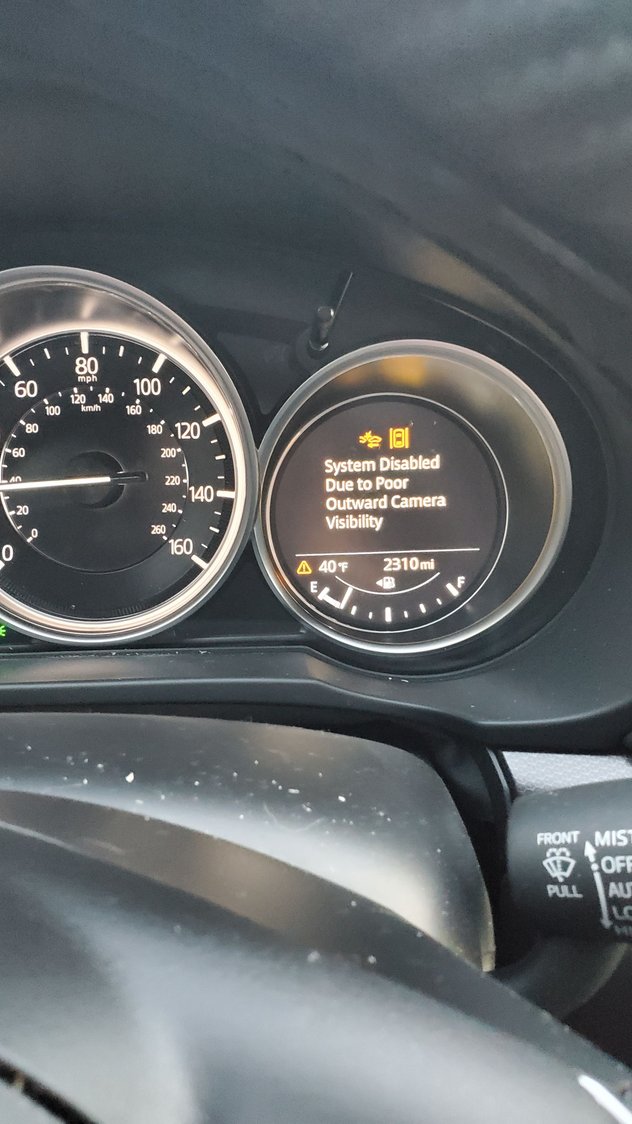

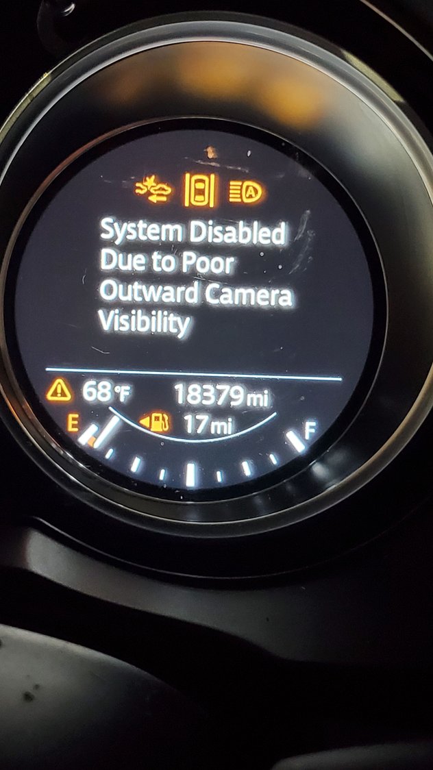

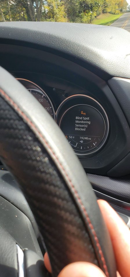

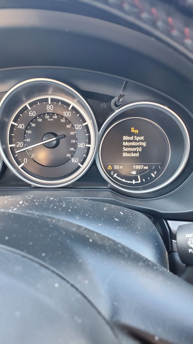

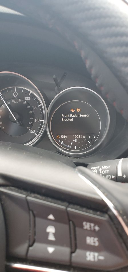

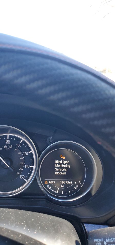

I have the photo proof that the issues started at no more than 477 miles. I did not take photos of the first couple of times because I thought it was due to being new and would work itself out. I also have over 50 other photos of the same issues on different days, different mileage, and different outside conditions. Here are a couple, one at the 477 mark was my first photo of the issues and as you will see some taken within seconds of each other with different warnings about different sensors as well as the picture of the windshield showing no bugs on window camera and the outside conditions. Of course these are not all of the photos have, just a random few to explain my issue.

I've taken pictures with my phone of me driving a Lamborghini, but I can assure you it wasn't my vehicle.
A big issue with pictures, is what does the observer of your pictures actually see.
Except for perhaps the blue & white windscreen sticker anyone looking at those pictures would have no idea whose vehicle that is.
It could be any Mazda CX-5 or any Mazda with that instrument cluster.
Unfortunately, without definitive markings and/or documented witnesses, those pictures won't do you much good in a lemon law filing or court scenario.

Well turns out, after spending 2 hours on the phone going over each pictures I had to send Mazda Lemon Law Rep, there is an issue with my BSM. So, according to the rep, his engineers have stated at some point during the make of my vehicle they switched material suppliers and the bumper design is slightly different than previous bumpers. He stated that the blind spot monitoring sensors are calibrated for the specific bumper design which my bumper is not the same. He further stated that the engineers are working on a firmware update for the issue.
so, at this time all I can do is wait for the new firmware!
I'm not stupid, nor am I a complaining type individual. I am well educated and much experience with all types of vehicles. I knew there was an issue and that has been acknowledged. So, thank you to all who understood there was an actual issue with my vehicle and sorry you were wrong, to those who thought i was just unsatisfied or incorrect about there being an issue.

Also, by the way. The pictures which show a date and time stamp as well as mileage were able to help sync the background info Mazda has on the vehicle. They were able to literally see every instance that my car had a sensor come on and then were able to link that info to the pictures provided.
Little did I know, MAZDA KNEW THE WHOLE TIME my sensors were coming on so frequently.
