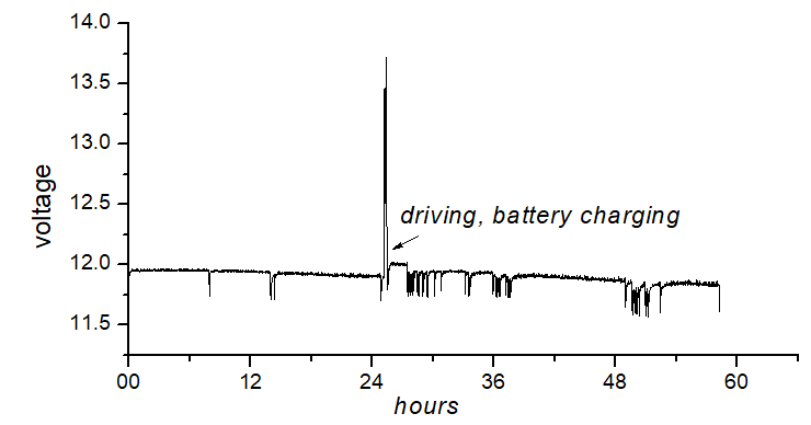

Fuses won't help. The increased current is a consequence, not the cause. The cause is something that triggers the wake-up of the main modules. Under normal conditions, this would be opening a door, the key fob, or remote start. In my case, some module is sending a wake-up signal. A long-term recording with a CAN logger might help to see which module is the initiator. Here's a graph over 60 hours. Random wake-ups are very difficult to diagnose. I’m planning to continuously record the dashboard on video to see if the screen turns on during these random wake-ups.
I don't know how to handle this problem, or at least, how to get Mazda to acknowledge the problem. This requires a really good engineer who understands exactly how everything works — like an automotive version of Dr. House.
P.S. This plot is uncalibrated, must be multiplied by 1.055.

Originally Posted by obelix662000
Hello. CX5, 02/2024, 15000 miles. 1. About a month ago, we found the vehicle completely dead because the battery was drained. It had been sitting unused for 4 days. 2. We recharged the battery, and everything worked fine for a few days—until the same thing happened again after the car sat for 3 days. 3. I used a voltage logger (with its own battery, recording voltage every minute) to monitor the battery. Normally, the car goes into sleep mode about 5 minutes after it's turned off, using very little power. It can stay like that for 1,2 or more days, but then, without anyone touching it, it suddenly goes to erratic behavior with periods of wakes ups and sleeps. The power draw increases, which we can see from small drops in battery voltage (see Figure 1). 4. Once, we got a “keyless system malfunction” warning and the start button was blinking, even though both of our key fobs were working normally. Disconnecting and reconnecting the battery fixed it.
Obviously, there is some electronic module inside that erratically push vehicle in some wake up-sleep cycles which drain battery fast.
At a dealership I was told they cannot investigate or fix the problem unless it's actively present at the time of visit. They replaced the battery, but of course it did not help.
Any advice what I can do? Now I'm just disconnect the battery if the vehicle stay more than a couple of days. This is very annoying.
May be I can report to Mazda headquarter department somehow? Probably they have some repair statistics of similar problem?
After 10 hours of normal stay (sleep) some electronics inside goes into wake-up sleep cycles. It drains battery fast.
After about 3 hours of driving the vehicle was OK for 2 days. But any moment it can happen again
