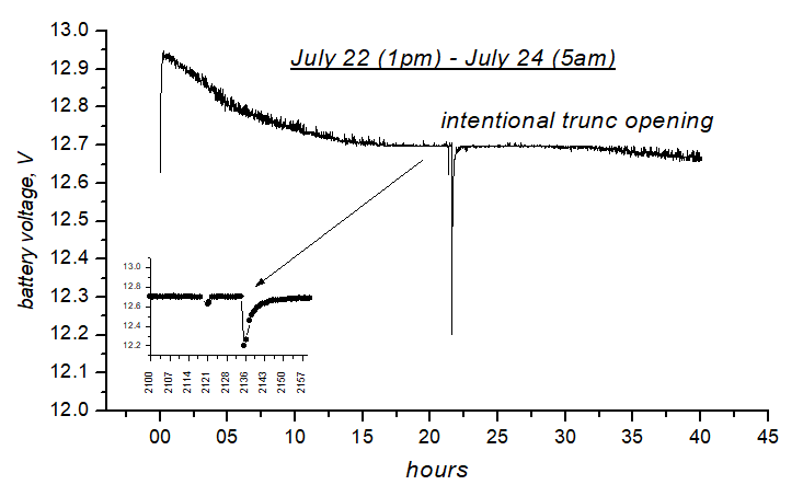

Hello. CX5, 02/2024, 15000 miles. 1. About a month ago, we found the vehicle completely dead because the battery was drained. It had been sitting unused for 4 days. 2. We recharged the battery, and everything worked fine for a few days—until the same thing happened again after the car sat for 3 days. 3. I used a voltage logger (with its own battery, recording voltage every minute) to monitor the battery. Normally, the car goes into sleep mode about 5 minutes after it's turned off, using very little power. It can stay like that for 1,2 or more days, but then, without anyone touching it, it suddenly goes to erratic behavior with periods of wakes ups and sleeps. The power draw increases, which we can see from small drops in battery voltage (see Figure 1). 4. Once, we got a “keyless system malfunction” warning and the start button was blinking, even though both of our key fobs were working normally. Disconnecting and reconnecting the battery fixed it.

After 10 hours of normal stay (sleep) some electronics inside goes into wake-up sleep cycles. It drains battery fast.
After about 3 hours of driving the vehicle was OK for 2 days. But any moment it can happen again

For a static situation those voltage drops are quite high when the activity takes place. Removing fuses and watching is abt the only way you'll get it sorted. Following with interest.

Current goes through FUSE 54(25A) "ROOM" and FUSE 40 (15A) "interior" according to this diagram https://www.startmycar.com/us/mazda/...o/fusebox/2024
The current (~3.5A) and fuses are typical for situation when car wakes up (e.g when door or trunk is open). To me the malfunction is arbitrary wake up of one of the modules. I searched TSB, there are no similar for my VIN
