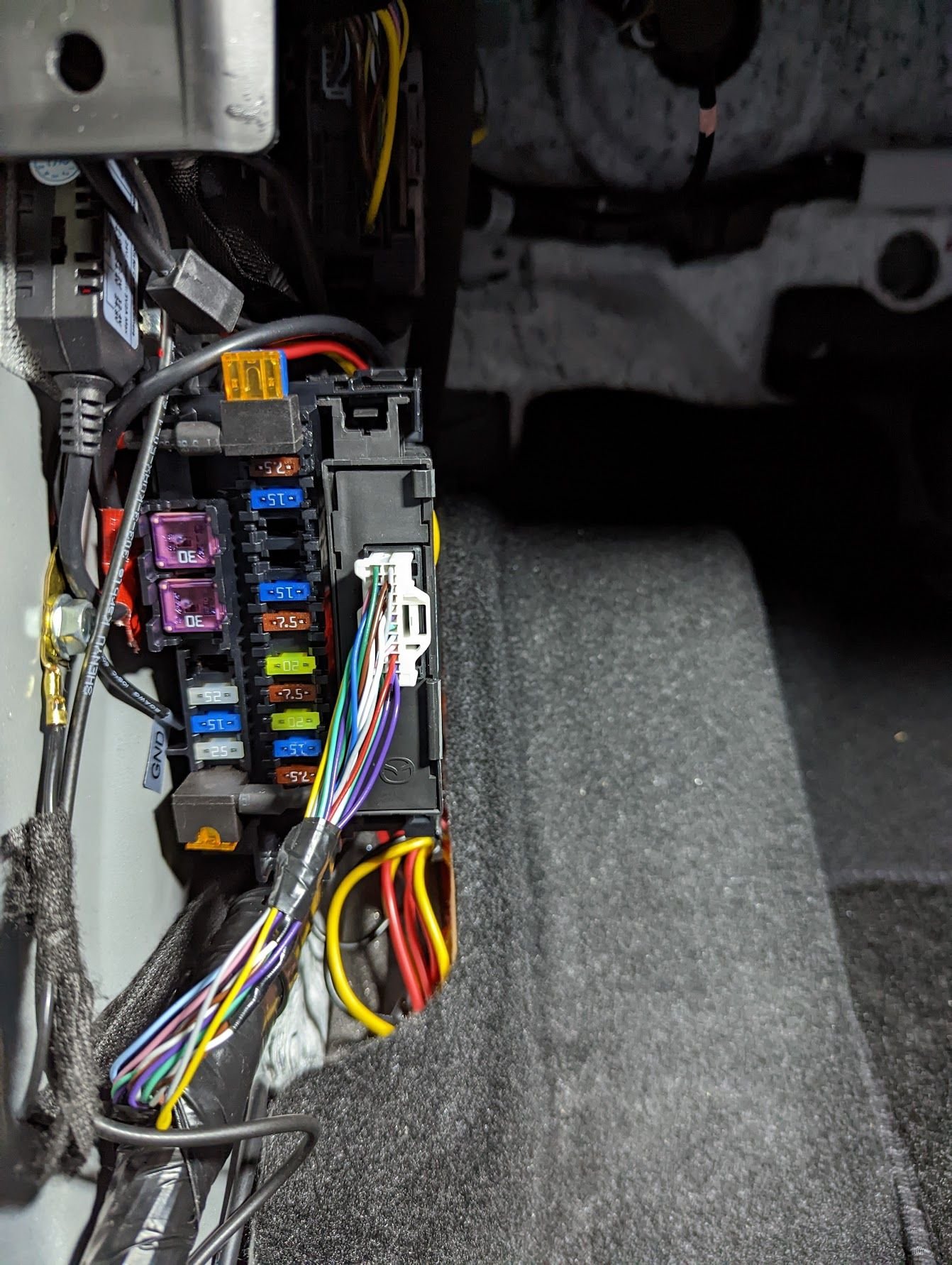

I've bought a kit (from viofo) containing 4 types of fuse-taps.
In this car right raw of fuses has plastic latches standing out ~2mm and blocking low-profile mini tap from entering deep enough. The left raw doesn't have the latches, and the low-profile mini tap works w/o any problem. In the left raw I've used LP fuse tap from the kit as-is, I've tapped "SEAT WARM 20A" fuse for always-on battery connection

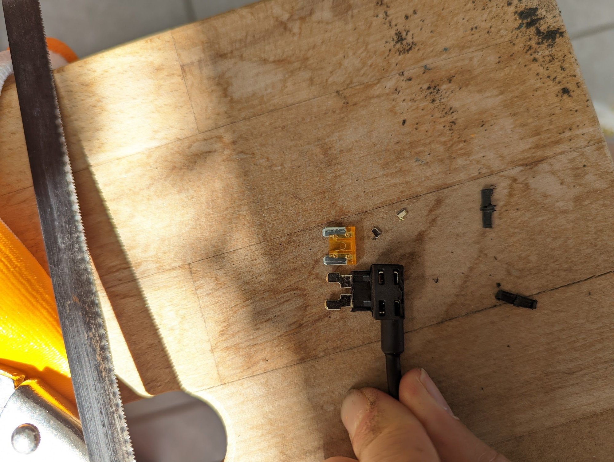

For the right tap raw I've used a "regular mini" type (as opposed to a "LP mini" used for the left raw) as suggested in previous posts (I tapped "F. outlet 15A" fuse for switched power connection),
except I've also shortened its legs as these were too long and it was standing out too much.
