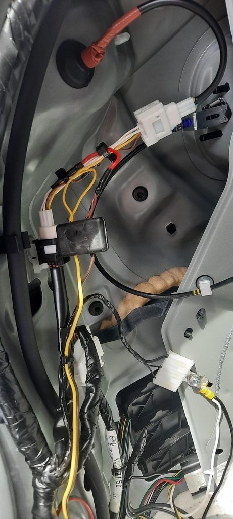

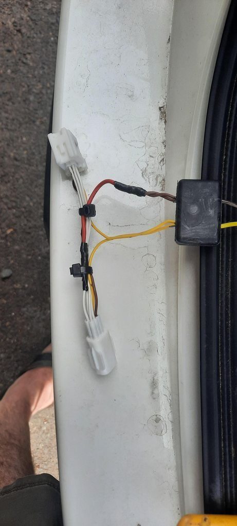

Ok! I have a good update to share. I have figured out the correct running light wire on the vehicle and spliced in the trailer wiring. All works as it should now!
This again is for a 2022 CX-5 Premium. Using the same T-One Vehicle Wiring Harness with 4-Pole Flat Trailer Connector ITEM # 118746. This was previously listed on Etrailer's website as being compatible with the 2022 CX-5. It has since been removed.
The best part is that I did not have to splice into any of the Mazda factory wiring. Only re-wiring the tow connector harness.
Basically, the brown wire from the tow connector (coming out of the black box) is currently spliced into the wrong pins on the vehicle end connectors. The correct pin is directly opposite end of the connector and diagonal (white) as shown in the images. You should confirm with a voltmeter that this is indeed the right pin on your vehicle (12v coming out with running lights on). I assume it is though. Mine is the Premium model (running lights active on the hatch).
The work will all take place on the driver side connection only as that is where the running light wire from the tow connector goes.
To fix the issue:
  • Open up the cargo area to access the wiring connectors.
  • Remove the wiring connectors from the vehicle ends.
  • Cut the 2 brown wires coming off the trailer wiring after OR before the little black box. (the little black box is simply a splice connection). I chose after. Does not matter. The brown wire from the tow harness is the trailer running light wire.
  • On the harness, splice the now 2 hanging brown wires back together.
  • Locate the correct wire (12 v running light), I am pointing to it in the pictures below, but please confirm prior to splicing for your specific vehicle.
  • Take a new piece of wire, or directly connect the brown wire to the white 12v running light wire. (I used a jumper wire as shown below, in red)
  • Button everything back up and you should be good to go.
  • Total working time was about 1.5 hrs.
I recommend soldering and heat shrink for the connections. I did not have any heat shrink so I went with electrical tape and zip ties. Splicing connectors would work as well if you do not have a soldering iron.
Splices shown:
12V Running Light Wire:
Newly Spliced Connections:
Re-Installed on Vehicle:
All Back Together and Working:

Thank you so much Anthropic! It worked! Absolute legend for figuring this out!!
For anybody else reading this, the above instructions worked for my 2022 Mazda CX-5 Turbo.

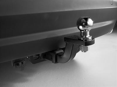

FYI: A thought for those who have not yet purchased a hitch.
The Mazda OEM wiring harness is plug-in and comes with the OEM trailer hitch.
You will pay a maximum of about $50 less on an after-market hitch but they don't come with the built-in connect bracket and cover to plug in your trailer.
The OEM hitch while smaller in size also hides under the bumper and prevents you from hitting it when the receiver is removed.
Your shins will thank you.
