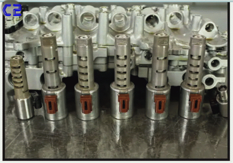

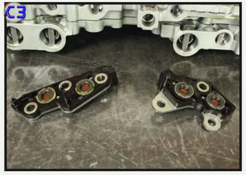

OMG.... what part of your MAZDA Skyactiv transmission is not like the power glide in your old Chevy that some of you seem not to understand?
Below are only 3 pictures of parts (solenoids and valves that are directly affected and influence the shifting of the transmission in your MAZDA. When the transmission fluid is not warmed up these do not operate smoothly and as they should. Thus causing the occasional feelings some of you are experiencing because you are in to much of a hurry .
I will also add that this valve body and a few others when taken apart and inspected for failure the findings were all because customers did not service their transmission because MAZDA claimed lifetime no service.
When you are out of warranty you are out of luck to get MAZDA to take care of your transmission issues and failures!
