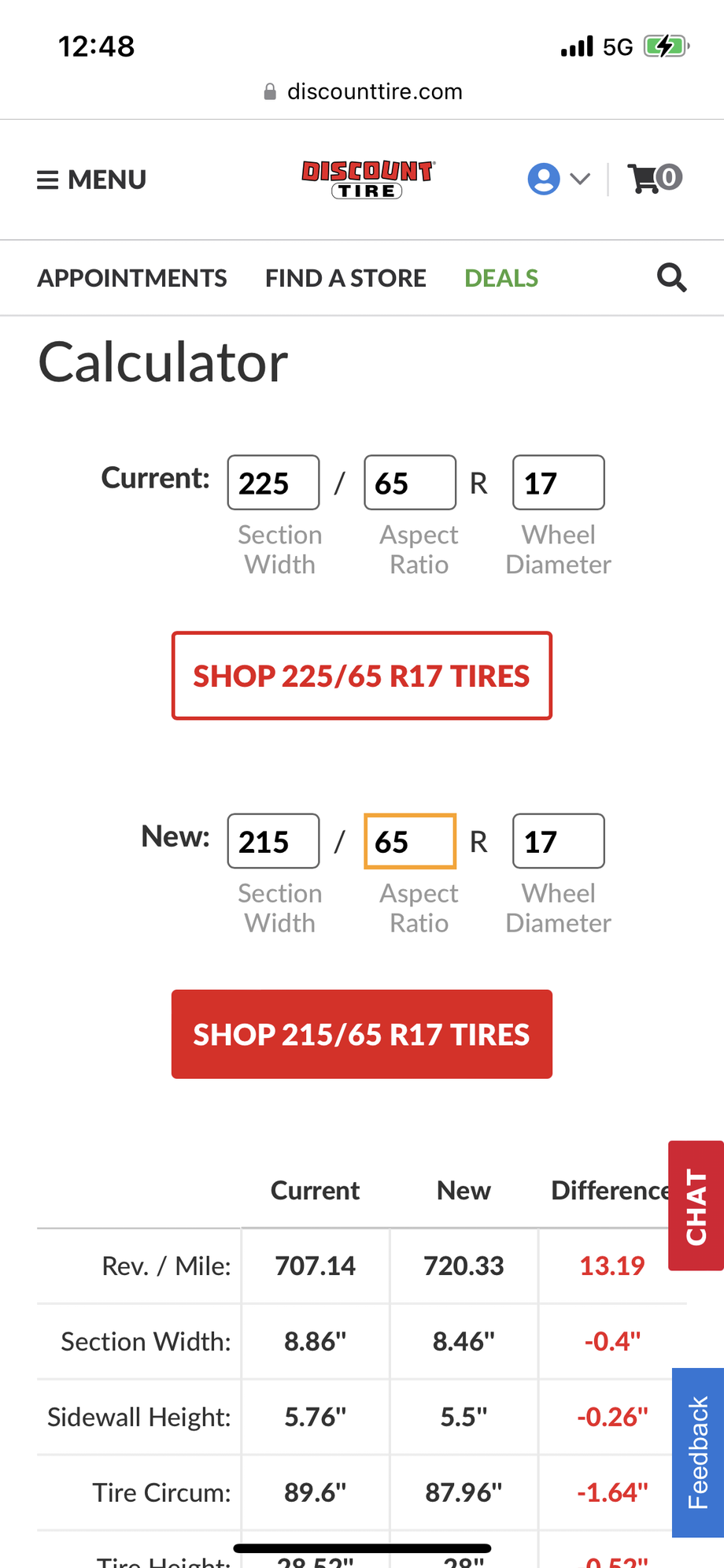

Default Goin to try narrower tire.
It has a heavier steering for more feedback like bmw.
Tried increasing psi to 45 psi. Going to change to a narrower tire from 225/65r17 to 215/65r17.
The slightly shorter height should also slightly increase braking power and acceleration without much speedometer error.

Not the best advice. ^^^^^^^^ . You DO NOT INCREASE tire pressure to adjust turning feel of any vehicle.
In other words you do not correct what may be a mechanical issue with tire pressure not recommend by the auto manufacture which is in the drivers door jam.
If anyone thinks that there is a steering issue because it is electrically controlled (even if mechanically controlled) it is very important to seek out either a MAZDA dealer or a service shop and have the steering and suspicion inspected.
DO NOT INCREASE THE TIRE PRESSURE TO COMPENSATE FOR HEAVY STEERING

Tried increasing psi to 45 psi. Going to change to a narrower tire from 225/65r17 to 215/65r17.…
Welcome to Mazda Forum! I’m afraid that not only will increasing the tire pressure not work, neither will a narrower tire because the steering is electric, not hydraulic or mechanical. Your problem may have nothing to do with the OP’s issue. BTW, the OP hasn’t even been back to the forum in over two years, this is a zombie thread started in 2020. We know you are new here, but usually it is best to start a new thread than it is to revive a dead one.
