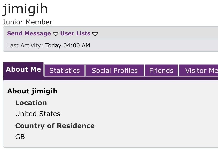

The thermostat in a Skyactiv N/A Mazda gas engine is 195f . The operating temperature of coolant during summer in areas ambient ubove 90f will be 190f without AC. With AC it reaches min 195f and up to 210f . The under hood temperature even in Those conditions would rarely not exceed 220f if the HVAC was used . The battery is semi insulated by design from Mazda in its mounted area and if a quality battery is used can last 5 years or more in that environment.
While heat does effect a batteries life it is the least effect in Skyactiv N/A Mazda platforms.
Sorry about the guessing but you limited profile info was confusing
GB generally mean Great Britain (residence) but you showed USA (Location) and then added with * Bay St Luis ? ( average summer temperature 33c )
There is no "GB" state in the USA
